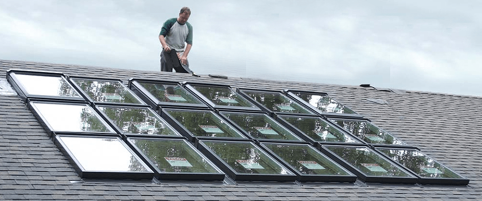

The unusual 70-inch-on-center truss spacing created three basic bays that I would need to subdivide into smaller mulled openings. The trusses measured 5 1/2 inches wide, leaving a 5-foot-4 1/2-inch space between them. I found that two Velux roof windows with a unit size of 30 9/16 inches wide by 46 1/4 inches high that would fit side-by-side between the trusses, with just enough room for a double rafter between them. In fact, the two units’ combined width of 61 1/8 inches left only 3 3/8 inches — not quite enough space for the framing and the recommended 1/4-inch rough-opening clearances. But because the units would be deck-mounted, not inserted into the openings, I figured I didn’t really need any wiggle room, provided the framing was meticulously square.
Referring to installation information on the Velux website, I drew a layout schematic. The final design contained a total of 18 windows — six across stacked three high, with alternating 3-inch and 6-inch spacing in between. Fortunately, the side-to-side “combi-application” flashing kits provided by Velux allow for spacing from 2 1/2 to 12 inches wide in 1/2-inch increments. Head-to-sill stacked spacing is restricted to 4 inches. Along the top and bottom, about 12 inches and 6 inches, respectively, are needed to accommodate the head and sill flashings.

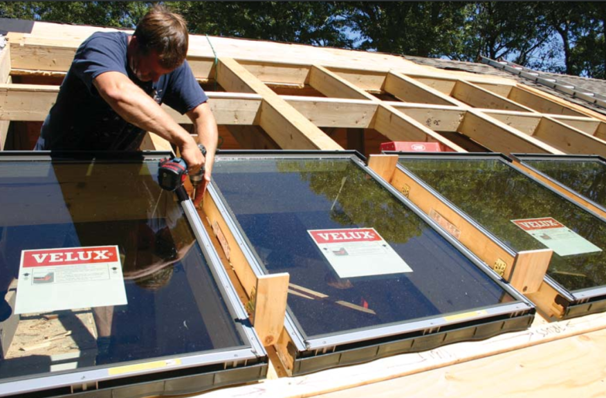

On the ground, we prepped the units by removing the aluminum cladding as instructed and folding the installation brackets out from their shipping position. The bracket locations were already offset from one side to the other to avoid conflict when combining units. We snapped a chalk line square and parallel to the opening’s bottom edge and screwed the story stick down alongside it. The stick supported the first row of units and guided its placement. We started arbitrarily at the lower right corner and worked to the left.
The window package includes 1 1/4-inch annular-ring installation nails, but we used 2-inch-long #8 Fastap Plus screws instead. Screws are easier to remove when adjustments are needed, and they’re plenty strong. I cut plywood spacers to precisely control the flashing gap between units — 3 inches wide and 6 inches wide for the side-by-sides, and a set 4 inches wide for stacking the units vertically.

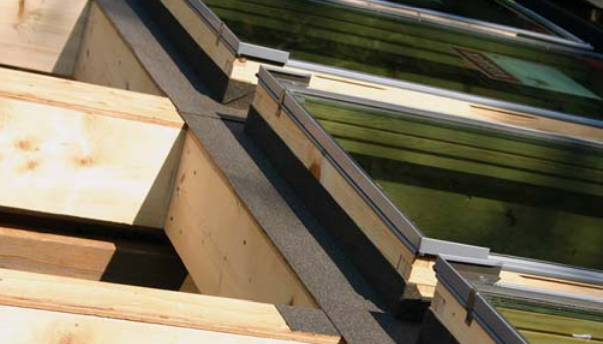

The installation manual requires roofing underlayment around the window frame, folded up from the roof onto the sides and wrapped in sequence from bottom to top around the four corners. We used self-adhesive membrane, beginning with Vycor in 6- and 9-inch-wide rolls. Between units, we had lots of three-way U-shaped folds to make. We scored the release paper on the back so we could bond first to the roof deck and then to the frames. But in the August heat, Vycor’s release paper tore away in annoying, uncontrolled strips. Picking at it only made the problem worse, rendering the product useless. Vycor is undoubtedly great when laid flat around a vertical window — the problem was in the folding.
We switched to 3-foot-wide ArmourGard Ice & Water Protector, which has a silicone-plastic backing that reliably peeled away in one piece. We cut it into the widths needed and scored the backing with a razor knife. Although thinner than Vycor and a little trickier to score without slitting all the way through, it worked like a charm, even in 90°F weather.

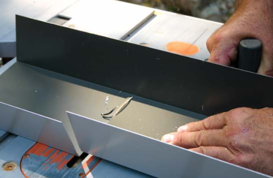

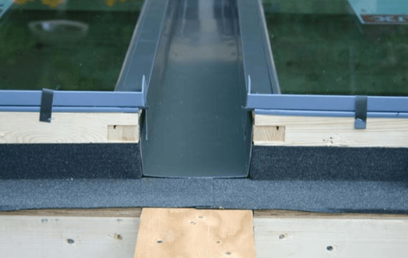

With the underlayment wrapped around the frames, we next installed the flashing, starting with the bottom aprons. There’s an integral rubber underglass gasket on the unit that must be pulled over the top of the apron’s rim. A slide-on clip engages the aprons’ upturned hems and makes a watertight connection between them. U-shaped aluminum channel flashing fits between units and overlaps the apron flashing by 6 inches. The channels are made for use with all models and, in our case, had to be cut to length. I used a plywood sled on the table saw, rotating the piece to cut one side at a time with a shallow-set 40-tooth ATB carbide blade. This made a clean, factory-grade cut.
Cutting the flashing on the table saw prevents the distortion created by using snips.
The channel gets cut flush with the heads and is then overlapped 6 inches by the combination head-sill flashing.

There were four venting units along the top row — one at each outside corner and two in the center truss bay. After installing four units using the plywood spacers as usual, we sighted a misalignment from down below, when we peered up the channels. This made no sense at first, but we found that, unlike the fixed windows, the venting units allow the frames to rack out of square. Good thing we used screws. We pulled three windows, realigned the first corner unit, and the rest went according to plan.
