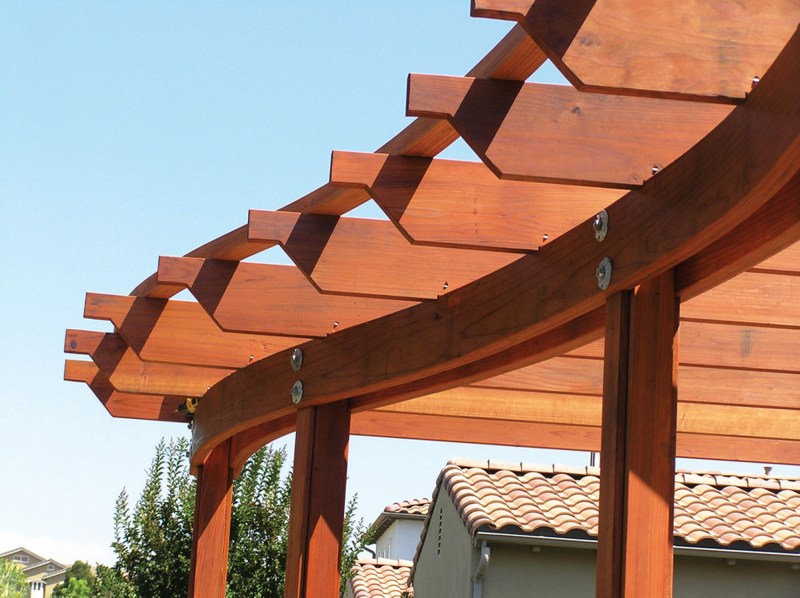

Next, he lifted the beams into position and bolted them to the support posts. Then he installing the rafters and capped the pergola with the curved laminated stringer that he had glued up simultaneously along with the support beams.

The arched subrails shown here and the sweeping pergola rafters in the photo at right are just two examples of how the author has incorporated curved laminations into his projects.

To make the long curved beams and stringer for the redwood pergola featured later in this article, the author started with thin stock sourced from a local lumberyard.
OLYMPUS DIGITAL CAMERA
He screwed the first layer to the pergola’s support posts, then applied construction adhesive to each additional layer as he built up each component, one lamination at a time.

Then the author cleaned up the edges of the beams with a power planer and random orbit sander, rounded over the edges with a router, and trimmed the beams to length.

Finally, he installed the remaining straight redwood stringers to complete the project.
