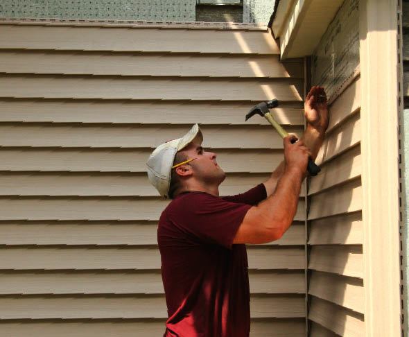

Installation Upgrades
As with any exterior cladding, it pays to spend a little more for good looks, especially in an upscale neighborhood. Specialty remodeling contractor Bert Labhar, for one, believes that contoured backing is “100 percent the way to go.” Skip the backing, he says, and “the job won’t look inferior the day it’s done — but it will within a year or two. Siding expands and contracts, it buckles and bows, seams start to show, you get bubbles and indentations, and pre-existing wall lines telegraph through. It just looks cheap.”
Lap reduction. The best way to reduce or even eliminate repetitive patterns of double- or triple-course lapped butts — a dead giveaway that the siding isn’t wood — is to use longer siding lengths (Figure 5). Panels of up to 16 feet 8 inches are sold by all major siding manufacturers and, when compared with standard 12-foot lengths, can reduce the occurrence of lap joints by 40 percent. Single-course planks — with 5- and 7-inch profiles — are also available; with these the random butt patterns seen in wood or fiber-cement siding can be mimicked even more closely.
J-channel. Like wood siding, vinyl expands and contracts with temperature fluctuations, but with proper nailing, the elongated slots in the nail hem accommodate the movement. At window, door, and corner terminations, the siding must be cut short by 1/4 to 3/8 inch and the ends concealed in J-channel trim.
On some homes, this can pose a problem: Outlining every window, door, and corner board with channel just doesn’t look right on a traditional facade. Some historic districts prohibit J-channel trim altogether — which is no doubt why, when you look at vinyl-siding product brochures, it’s conspicuously absent from most of the images.
Probably the most common solution is to use trim coil and integrate the channel when cladding over the existing trim. Dedicated trim products — window lineals and corner-post profiles — are also available with the channel built in, for an uncluttered, “normal” appearance (Figure 6). Strategic shimming behind standard trim can also create the necessary recess.
