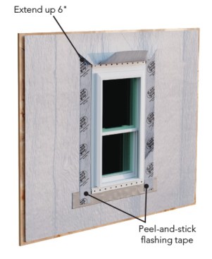

Integrated window and door flashings. When installing flashing around windows and doors, be sure to integrate adhesive flashing tape and housewrap. At the bottom and sides of the window, the flashing should lap over the housewrap, but at the top, the housewrap should lap over the flashing.
First, apply adhesive or metal flashing to the underside of the windowsill or door, then apply to the sides, ensuring that both sides overlap the bottom. For the top, metal flashing can be used to direct water outward and away from the window or door. The flashing should extend past the nail flanges of the window, to divert water outward and over the flanges of the siding panel.

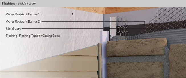

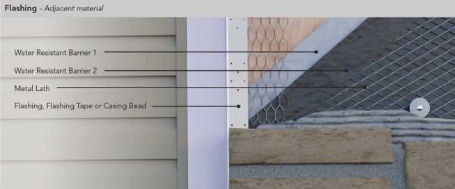

For inside corners on siding, use extruded aluminum inside corner W flashing to prevent water seepage. For transitions – areas where siding meets trim or stone – install metal J flashing between these products to create a water barrier.

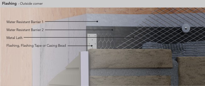

For manufactured stone installation, all flashing materials must be corrosion-resistant, integrated with the WRB, and installed at all through-wall penetrations and at terminations of adhered manufactured stone veneer (ASMV) installations. One layer of house wrap covered by two layers of WRB is recommended.
Siding transitions. Where siding meets up with manufactured stone, the proper flashing materials must integrate between the transitions, or water will flow down from the siding and weep into the WRB and sheathing behind the stone. The wall must have a continuous drainage plane behind the siding that draws water away before it drains into the stone. The water-resistant barrier materials should be extended at least 6 inches above the transition.
Use a metal L-shaped flashing and tuck it under the bottom row of siding, allowing the horizontal edge to be positioned over the top row of the manufactured stone.

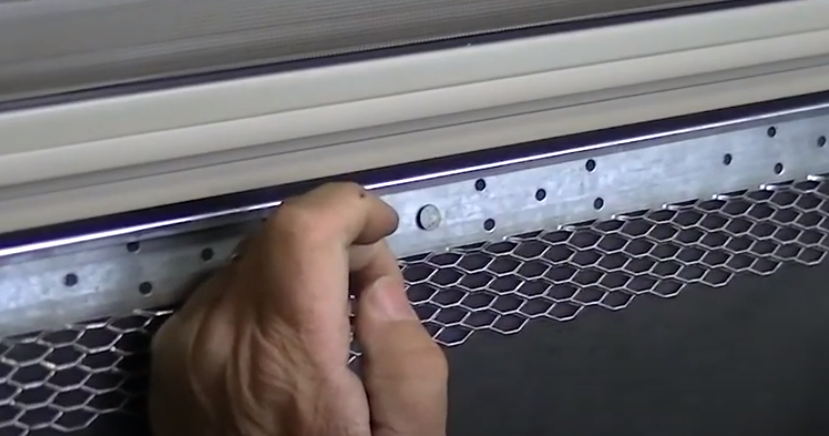

Weep screeds and other base flashings should be used at the base of the wall to allow water to drain and exit. They should be held a minimum of 4 inches above grade or a minimum of 2 inches above paved surfaces.
