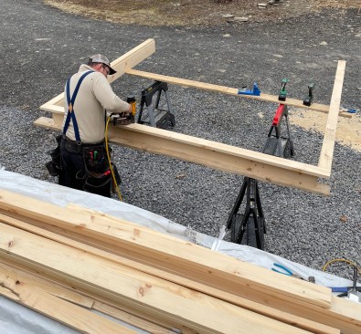

After framing the garage and making sure that the Zip System sheathing was fully taped and rolled, we turned to the first step of the siding process: building and installing door jambs and casing. Similar to the siding, the stock for the trim on the garage was simple #2 pine—in this case, 5/4 stock. Because the outside of the WRB would have 1/2-inch furring strips installed over it to create a drainage plane, we needed to install furring around the rough openings and extend the jambs 1/2 inch past the sheathing so the casing would be well supported and tight to the jambs with a traditional reveal.

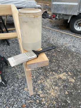

We cut the 5/4 jamb components to length, then fastened them to each other with coated deck screws. We butted the casing joints and joined them using Kreg pocket holes with blue-coated screws. This would keep the faces nice and tight. Running a 1/8-inch round-over bit over the pieces softened the edges and eliminated splintering. We prefastened the casing onto the jamb sets with 15-gauge stainless trim nails, using a carpenter’s pencil as a gauge to create a uniform reveal. The end grains that would sit close to (but not on) the concrete floor would be waxed.
Finally, we installed the site-made preassembled jamb and casing sets as whole units. Here, we also used 15-gauge stainless trim nails, giving thought to the fastener layout. Because all the pine material would be left to naturally age, we did not fill any nail holes.

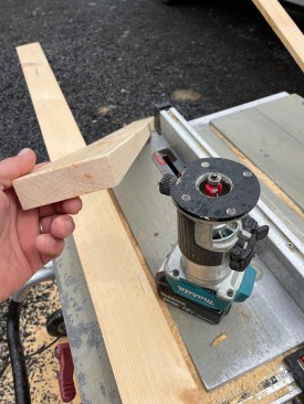

Similar to the door casing, the outside corners, also made of 5/4 stock, would need furring strips behind them for the siding to plane out nicely. We built the corners using the same Kreg pockets and coated screws as on the casing. We ripped the adjacent corner board minus the thickness of the stock so that visually the corner has the same width on both faces. (It drives me nuts when carpenters don’t take the time to do that. It looks goofy to have one side wider than the other.) These corners also got dressed with the 1/8-inch round-over bit and waxed end grain. The assembled corner pieces were fastened to the building with 15-gauge stainless trim nails, again with thoughtful layout given to the fasteners.

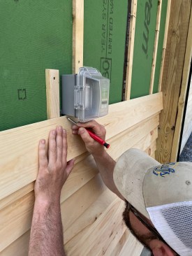

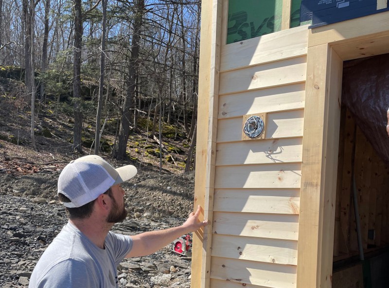

Mounting Blocks

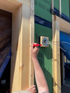

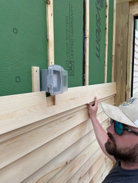

With the courses of siding established by the story pole, we could locate the exact location and course where receptacles and lights would be installed. This was made much easier in our case because we self-performed the electrical work (which we are allowed to do in this municipality). Be sure to check with the local building department on licensing and inspection requirements. If you can’t do this work, it will take some coordination with an electrician.
Because we knew the exact width of the siding course, we could then make a square mounting block that would fill that coursing space. Most outdoor lights that we handle have a 4-inch round base. Coursing that is about 4 3/4 inches wide leaves a nice margin around the fixture base.
Due to the nuances of the electrical boxes, light fixtures, and wood mounting blocks, I found it easier to weatherize these areas with fluid-applied liquid-flashing rather than hard, metal flashing. I was also afraid that hard flashing over these blocks might be asking for water to travel behind the fixture base.

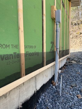

Furring Strips

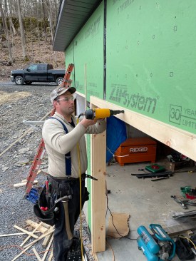

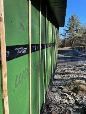

With the furring strips installed behind the trim components, we then needed to apply furring strips across the field of wall sheathing. We ripped regular dimensional 2-by stock down to 1/2 inch thick, placed the strips in line with the studs, and shot them with a 2 3/8-inch ring-shank nail. The furring strips can be made using nearly anything—corrugated plastic, Zip sheathing scraps, strapping, sheet goods, and the like. We chose to use dimensional lumber because we had plenty of it on site. We did not fasten the furring strips at the bottom of the wall, so that we could slide insect screening behind them.
Insect Screening
The furring strips created a gap between the back of the siding and the face of the WRB, and we needed to block that gap with insect screening. This would keep insects out but still let water drain out should it get behind the siding. We simply took a roll of fiberglass window screening and crosscut it to 8-inch widths on a miter saw. We unrolled the screening, tucked the back of it behind the bottom of the furring strip against the WRB, and shot the bottom of the strip; then we rolled the front flap of the screen up onto the face of the furring and held it in place with a T-50 staple.

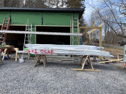

As with most efficient and successful construction, remodeling, and finishing projects, the prep work is where all of the heavy lifting takes place. Once all the trim, flashing, and furring strips are in place, and the casings and corners are marked using the story pole, the easy part is to start installing the siding.

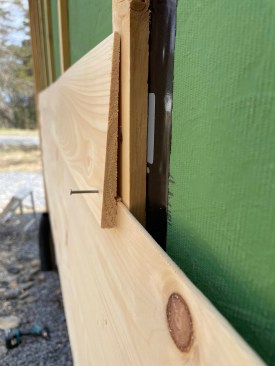

This build did not have a water table or skirtboard but rather just the first course of siding. We started by ripping a 1-inch-wide “starter strip” off the top of a siding board. Installing this strip behind the first course replicates the cant or angle of having a course below, since there is no full course below the first one. The remainder of the board that we use to make a starter strip can often be used as a finisher higher up the wall.

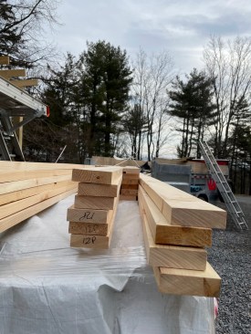

Our strategy for installing siding boards is to use long boards along big sections of wall and use offcuts and shorter pieces between doors and windows. It’s important to be mindful of what lengths were sent from the mill, to develop a plan on how to best use the material and mitigate unnecessary waste. When a single piece of siding can’t be used in a section, we like to snap a chalk line from one story-pole mark to the other to create a reference on the furring strips where the full course will be fastened. I avoid red or blue chalk and opt for baby powder or purple chalk. The latter will not stain anything and can be easily wiped off. Some folks use a slip sheet of tar paper or flashing behind joints, but I don’t find that to be necessary with today’s high-quality WRBs, and especially not over a rainscreen. Any water that infiltrates the assembly should run down the drainage plane and out.

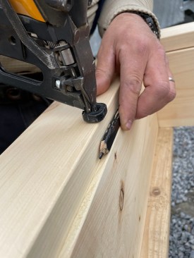

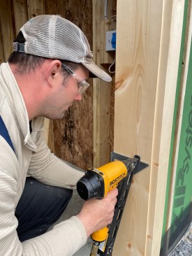

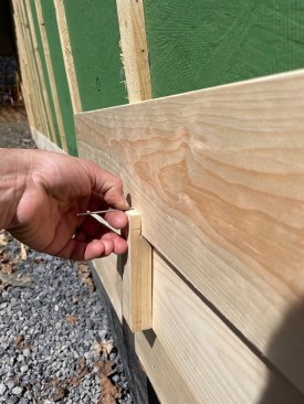

There are several schools of thought when it comes to nail placement on clapboard siding. We use a visible face nail, which can be installed in two main ways. The first is to nail close to the bottom edge of the board, ensuring that the nail punctures and captures the top of the course below. This means that each clapboard will have two fasteners in it—one low in the face and one high from the course above. While this securely fastens the board, it can create some challenges. Removing a damaged board from the middle of the field can be more challenging because there are double the number of nails to pull out. Additionally, and perhaps more importantly, seasonal changes affecting the expansion and contraction across the grain could result in a cracked or broken board. For those two reasons, I prefer an alternative method, which is to nail through the face of the bottom of the board high enough that it drives just above the top of the board below. The course above exerts enough holding pressure to keep the top of the course below tight to the wall, and we eliminate the previously mentioned concerns.
To ensure proper nail placement, we made a small jig that spaces the nail just above the top edge of the course below. While an experienced carpenter may find this to be an unnecessary step, I find it to be helpful. I quickly developed muscle memory to hold the jig and the fastener with my left hand while grabbing my hammer off my belt with my right hand. It’s important to note that as the reveal of the boards changes, so does the nail placement: A larger reveal means a lower nail placement, while a smaller one means a higher placement. We adjust to the reveal by simply scooting the jig up or down while fastening.
For fasteners, we went with 2-inch stainless, ring-shank siding nails. While siding nailers are undoubtedly faster, I continue to find hand-nailing to be superior. A slower pace promotes proper nail placement, and I find it easier to set the nail heads perfectly flush. Hand-nailing, however, causes vibration on the wall from hammering. In a remodeling or re-siding scenario, consider removing hanging pictures from interior walls. Drywall nail-pops can also occur.
I have always found a smooth-face, 20-ounce hammer works best for nailing siding. It has enough oomph behind it to easily drive nails but isn’t so heavy that it becomes laborious to swing all day. Some carpenters prefer a 16-ounce when installing siding because they can swing a lighter hammer faster. And a smooth face is a no-brainer—no one wants waffle marks on their siding from a framing hammer.

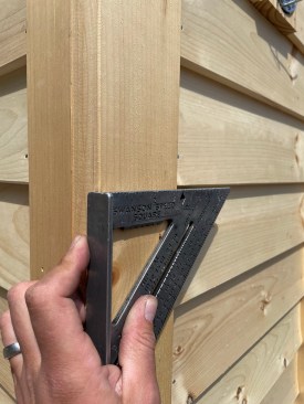

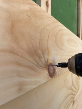

  • To avoid splitting clapboards, predrill for nails near board ends and knots.
  • Use a square to check that courses line up around corners.

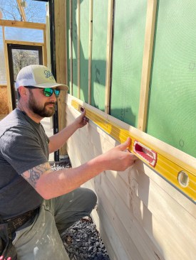

  • Every few courses, check that the siding is level.
  • Keep tabs on our stock of material lengths and waste factor.
  • Reserve the straightest boards for starters.
  • Beware of creep. One-sixteenth inch out of level or not in line with story pole marks isn’t a big deal, but repeated 1/16-inch mistakes compound quickly.

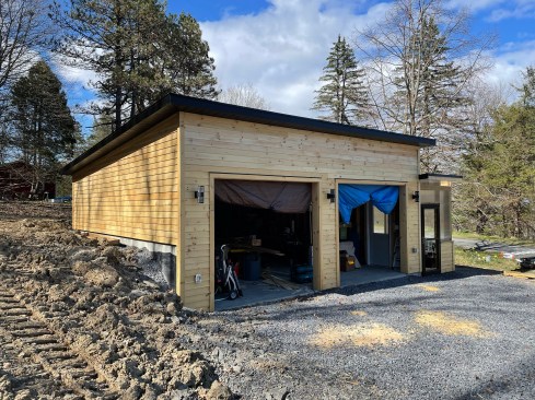

The installed clapboards will be left to weather to gray without any applied finish.
Wrapping up the siding job was pretty simple. When we began running the siding, we ripped the top of a fresh piece of siding to create a starter strip. At this point, we took the remainder of that board and used it as a finisher. We ripped the final course at the top of the wall to the width that was prescribed by our story board and butted it up tight to the underside of the frieze board. Sometimes, the top of the last piece needs an additional nail because there is no course above it to hold it tight to the wall. Here, we used a smaller, trim-head stainless steel nail.
