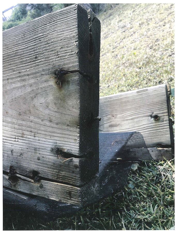

The injured count kept rising: According to a final report from Emerald Isle town manager Frank Rush, 26 people were injured in the collapse at the vacation rental home at 4403 Ocean Drive. An investigative report by Carteret County, North Carolina, building official Chris Jones concluded that corroded fasteners were the weak link that brought an 8-foot by 10-foot section of deck crashing nine feet to the ground. Local station WNCT has that story (see: “Final NC deck collapse report: 26 hurt, corrosion to blame,” by Angela Green). The town of Emerald Isle posted the Carteret County report on the town website here, along with a description of the emergency response and a discussion of the town’s policy options for preventing future deck failures (see: “Deck Collapse Final Report”).
Photos attached to the Carteret County investigative report show joist ends with the embedded remains of several badly rusted nails, reduced to almost nothing by years of exposure to salt air and rain. No joist hangers are evident. The report describes the deck assembly as a girder system projecting from the house, with joists toenailed into the face of the girder. Says the report: “The floor system is constructed of 8-ft. 6-in. long wood 2×8 joist spaced 16 in. on center supported by a 2×2 wood ledger nailed to a double 2×10 wood girder spanning 10 ft. The wood girder is supported by two 6×6 wood post. The fastening system consists of nails and bolts. The joist appeared to be connected with 16d galvanized nails, the ledger appeared to be connected in the same manner, and the girder appears to be connected with galvanized ?-in. bolts. It appears from the evidence presented at the site the determination can be made that the collapse is a result of corroded fasteners.”
The thirty-year-old structure complied with applicable North Carolina building code at the time it was built, the county report noted. In a phone conversation with JLC, building official Jones said, “The assembly didn’t fail. It was the fasteners that failed.” Routine inspection, upkeep, and maintenance could have prevented the event, Jones said.
And Jones told JLC he sees no reason to think that the deck would not have supported this year’s Fourth of July gathering when it was new. “If you do the math, that number of people of average size would add up to about 4500 pounds,” he said — reasonably close to the code-specified 45 psf floor design load. But when the failure occurred, he said, the original fasteners were no longer competent. “There was really nothing holding those joists up but the five-quarter decking that lapped over the joists onto the girder,” he told JLC. “As soon as they put that weight on it, down it went.”
