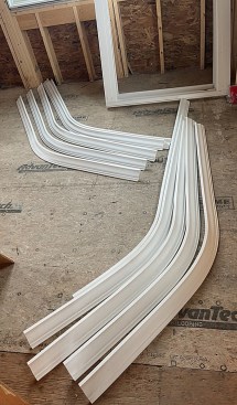

I make a bending form on a convenient area of subfloor on the job that we can keep clean while we’re doing the bending. The warm plastic is almost like a liquid, and it will conform to whatever you put it against, so it’s important that the form have a continuous edge that follows an even curve. To achieve this, I build a form with two stops, one on the inside and one on the outside. I begin by tracing out my radius and screwing a ripped piece of PVC stock to the subfloor following that radius. Then I measure the width of the trim board I’m bending and add a strong 1/16 inch to it because the trim board will be slightly expanded once it’s out of the oven. I then screw another stop along this outer line.
When bending a molding that’s nested, like a crown molding, I make sure the back (inside line) of my form is tall enough to support the molding while it’s in the nested position. An easy way to do this is to rip 1/2-inch PVC sheet stock down to the height needed and screw it to a bunch of mounting blocks following the curve. It’s kind of like one of those wooden snakes you can move around, except you secure the blocks to your work surface.

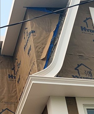

After cooling, the trim retains its curved form (left). For this project, crown molding was used to provide the flared edge common on many homes designed in Dutch Colonial and Tudor Revival styles (above).
Nathan Nebbia
