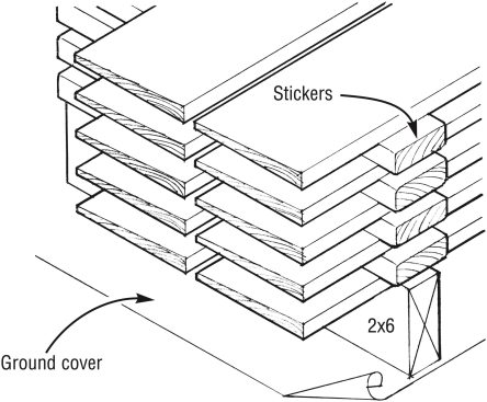

It’s best to get any wood siding at least a week early and store it at the job site to let it adjust to the site’s humidity. Extend drying period to 30 days for unseasoned siding or during very humid seasons. Keep siding out of weather in the driest space available. Break apart bundles and restack the material on evenly spaced, vertically aligned stickers to allow air to circulate freely. If stacked over the ground or concrete, lay poly down first, and then use 2x6s to elevate the first layer. Stack siding in a dry area where plenty of air can flow through the stack, and protect it from weather.

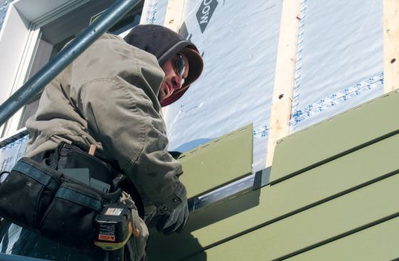

Horizontal Siding
Bevel siding is the most forgiving pattern because it’s designed to shed water, and cross-grain shrinkage will not expose the wall beneath.
  • To avoid siding failures, install all wood siding over an air gap created by battens or another spacing material.
  • Problems can develop from too much overlap. Buy bevel siding only 3/4- to 1-in. wider than the desired reveal. A large overlap may require double nailing (which can cause splitting) or nailing through the thinnest part of the board (which can lead to excessive cupping).

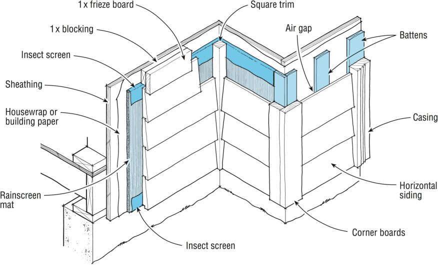

Drainage Plane
The easiest way to create a drainage plane is to use a self-draining rainscreen mat, such as Home Slicker® (Benjamin Obdyke; 800/346-7655; www.obdyke.com). This material is thin enough that windows, doors, and corners don’t need to be packed out when used with 5/4 trim stock.

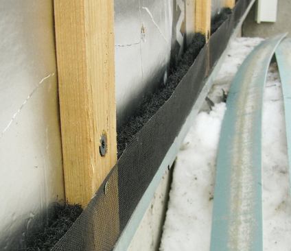

Also, siding may be installed over vertical battens spaced 16- to 24-in. apart to create the air space (Drainage Plane for Board Siding, below). In this case, door and window jambs must be extended to accommodate the added thickness, and a vent strip or screen should also be included over weep channels to keep out insects (Drainage Plane Details, below).

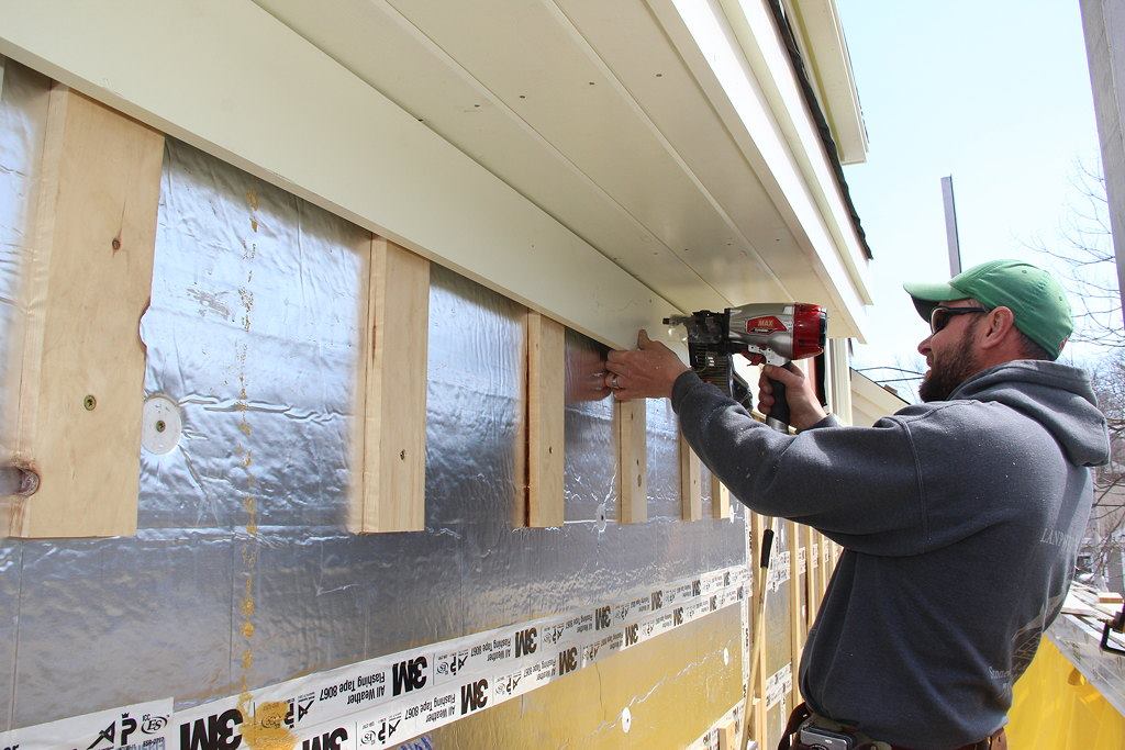

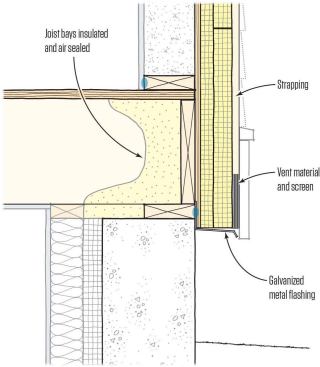

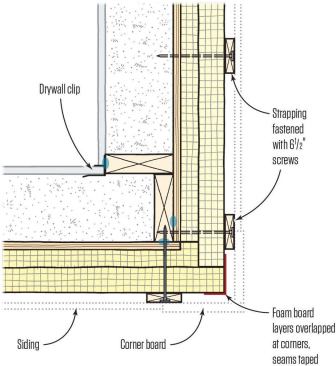

Board Siding Over Foam
Siding applied directly over rigid insulated sheathing has a history of failures because moisture gets trapped between the siding and the foam. Continued wetting and drying can lead to paint failure and cause siding to cup and curl.
Rainscreen over Foam
