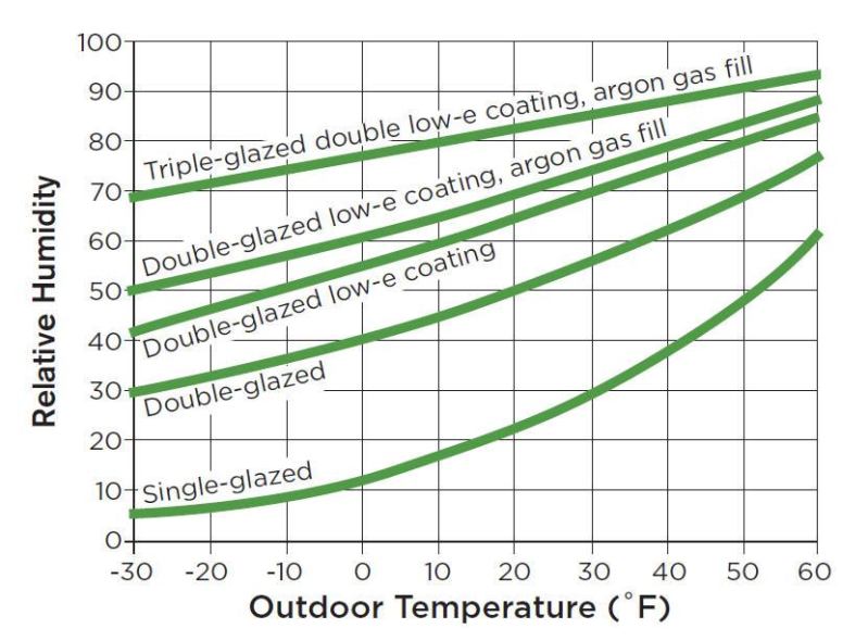

Given an outdoor temperature of 20F, project up vertically to the desired glazing curve. A double-glazed clear window, for instance, corresponds to a relative humidity of 51 percent. Compare this with a double-glazed low-E argon product, which would allow almost 70 percent relative humidity before condensation would occur. This chart is for the glass only and not the frame.

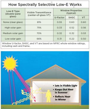

Since there are hundreds of window manufacturers, each with many different product offerings, it’s easy to get confused trying to sort through the trade names and marketing hype. Window options used to be limited to single-pane versus double-pane and wood frame versus aluminum frame. Today, there are three or four basic frame types, double- and triple-pane glass, and warm-edge insulating glass spacers. The low-E coatings used on most windows can be formulated for low, medium, or high solar gain. The terminology alone is enough to make your head spin, and most of this technology is hidden inside the window so it can’t readily be seen.

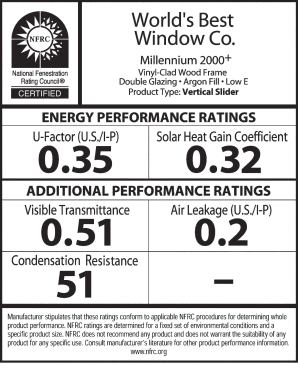

Thanks to the efforts of the National Fenestration Rating Council, most building codes now require windows to be labeled. (The NFRC is a collaborative effort between manufacturers, the Department of Energy, utility companies, and others.) The NFRC label gives you specific information about the whole window performance, not just the glass or components. For instance, a single pane of clear glass transmits about 90 percent of the visible light striking it, giving it a visible transmittance rating of 0.90. For the whole window, including sash and frame, however, that number drops to about 0.60 or less, depending on the specific window. (See below for a more complete explanation of visible transmittance ratings.)
The NFRC label makes it easy to assess a window’s energy performance. Which U-factor and solar heat-gain coefficient (SHGC) are optimal depends on climate. Optional ratings for air leakage (AL) and condensation resistance (CR) are included on this sample rating. AL indicates how many cubic feet of air leak through a square foot of window area, and generally ranges from 0.1 to 0.3. CR, which uses a scale of 1 to 100, indicates how well a window resists forming condensation on the inside of the glass. Higher numbers indicate better resistance. U-factor measures how well a product prevents heat transfer; the lower the U-factor, the greater a window’s resistance to heat flow and the better its insulating value. The U-factor is the inverse of the more common R-value measurement. For example, a window with a U-factor of 0.25 has an R-value of 4 (1/.25 = 4).
Solar heat-gain coefficient (SHGC) measures how well a window blocks heat from incoming sunlight. The number, from 0 to 1, is the fraction of incident solar radiation admitted through a window. The lower a window’s SHGC, the less solar heat it transmits into the house.
