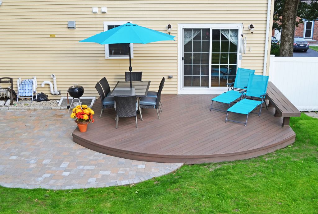

The finished deck rests on a hidden, buried treated-wood beam with helical piers, and is decked and trimmed with synthetic lumber. Below: the rough framing exposed during construction. See slideshows below for step-by-step construction details. (All photos courtesy Jim Finlay/Archadeck of Suburban Boston)
Our customer’s requirements were simple: Build an interesting deck and patio off the back of the house. The deck would be low enough to make rails unnecessary. We recommended curves, and the customer liked our simple, elegant design.

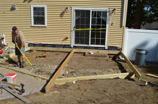

Post and Beam Construction

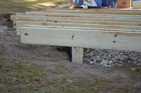

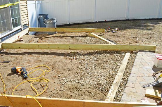

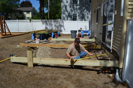

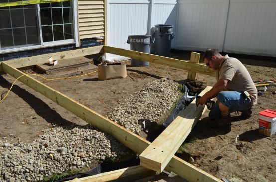

So, instead of a curved structural rim joist, we opted for post-and-beam framing. We would locate a carrying beam about 2 feet back from the deck’s front edge, under the joists. This configuration gave us two major advantages: First, it reduced the joist span so that 2×8 joists would be able to carry the load; and second, it allowed the joists to cantilever past the beam, which would make shaping the curve much easier.

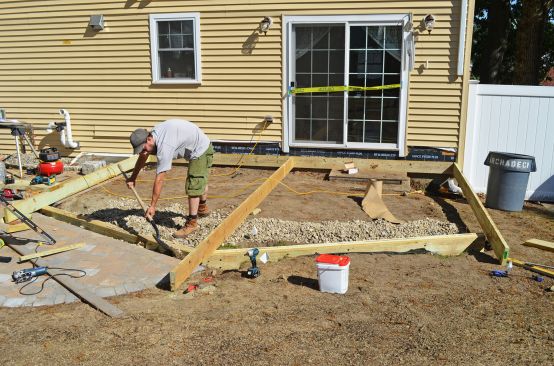

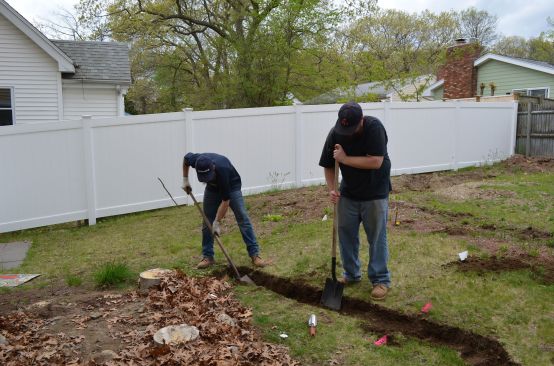

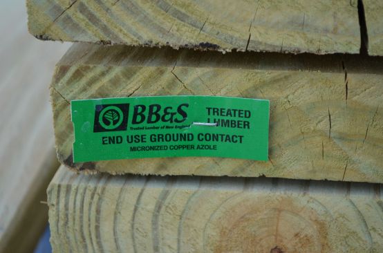

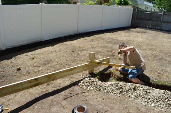

Post and beam did impose one disadvantage, however: Because the structure of joists on top of a beam would occupy 16 1/2 vertical inches, the beam would need to be set into the ground, with its top just about at grade level. We’d have to dig a fairly deep trench to accommodate the beam, with a drainage space around it. But that work was worth doing, because it would separate the rough work of installing footings from the fussy work of finishing the precise, symmetric curve. We’d rather trim a half-inch off the end of a joist than have to adjust the location of a footing 4 feet deep in rocky ground.
We drew detailed structural plans and calculated weight loads so we could size the beam and joists properly. Although our building code (IRC 2009) requires a 40-pound-per-square-foot (psf) live load for decks, we build all our decks to 60 psf. I still remember when the extreme snow in February 2015 accumulated more than 4 feet deep in the Boston suburbs. That much snow can indeed weigh 60 pounds per square foot.
Our design imposes a load of 429 to 595 pounds per linear foot (plf) along the angled beams. Over the 6-foot-3-inch spans between footings, we could have used double 2×10 beams; but triple 2×8 beams could support even more weight and saved us 2 inches of digging.

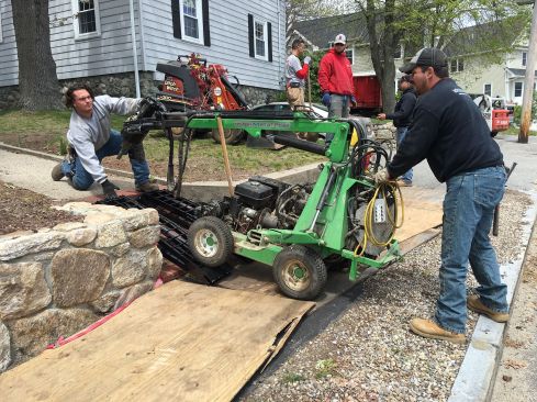

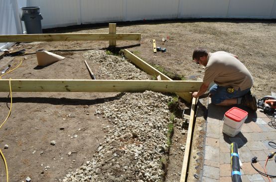

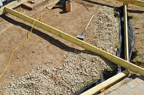

Trenching a beam requires more than just digging a long hole. The beam needs space underneath to prevent frost from pushing it up in winter. Over time, dirt would fill in that space, so we over-dug the trench, lined it with landscape cloth, and surrounded our below-grade beam with loose, clean stones. Those stones drain well and will move aside if frost threatens the beam. The landscape cloth prevents soil from infilling the spaces between the small stones.
Footings

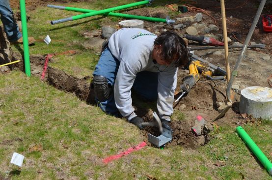

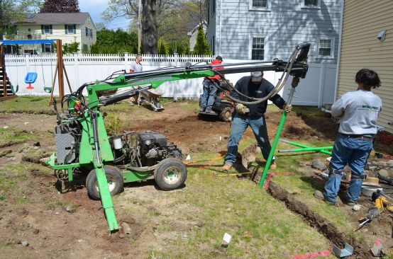

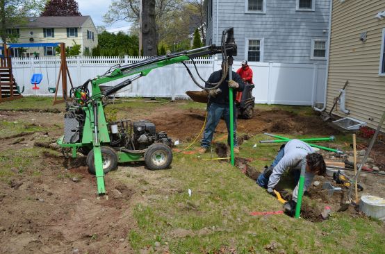

For the deck footings, we could have used concrete poured into Sonotube forms, but that method would impose two difficulties here. Digging for the tubes would be dangerous so close to the patio, and properly compacting the soil around the 4-foot-deep piers was not feasible: Soil would settle over time and cause the adjacent patio to sink. Instead, we used helical footings—long galvanized pipes with a large screw at the end. A hydraulic machine twists them into the ground without disturbing the surrounding soil, and the machine’s torque gauge tells us when the required bearing capacity has been achieved. We twisted each 7-foot helical footing into the ground below the frostline, and cut the end off once it exceeded the required bearing capacity. We then attached adjustable brackets to support our beam.
Framing

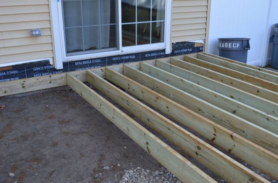

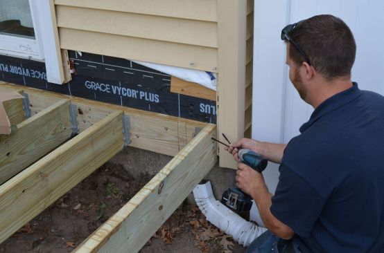

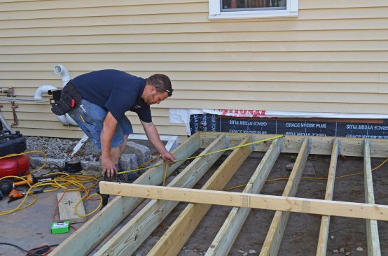

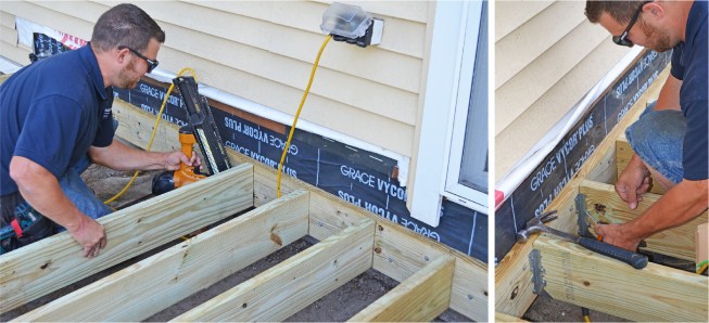

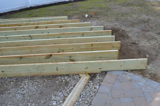

The initial deck framing was fairly conventional. After leveling our two reference joists, we inserted the beam below. The helical footing bracket adjusts easily on its screw, so setting the beam height was simple. Once the beam was set, we flushed the top of each joist even with our carefully leveled house ledger, shot nails to temporarily fasten the joist, then installed joist hangers.

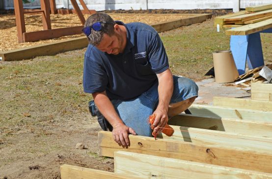

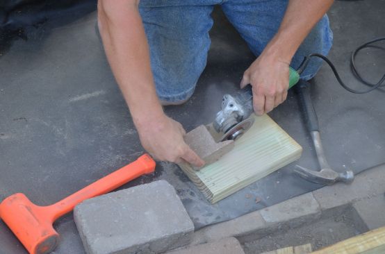

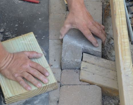

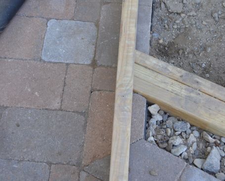

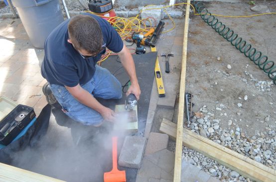

An interesting issue arose on the left side of the deck. Our design called for the deck to extend a few inches over the patio to hide its edge and provide a clean look. We could not let the side joist merely rest on the patio, because the patio is not a structure and is subject to frost. We had to support that side joist like all the other joists. Thus we had to extend our beam into the patio.
The solution was obvious, but somewhat tedious: We carefully notched the patio stones and reset them around the beam. It’s too bad the finished deck hides this craftsmanship.

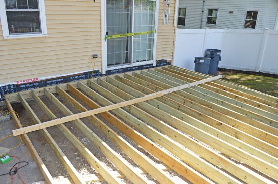

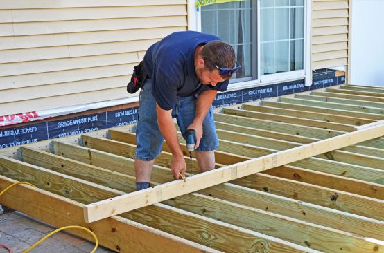

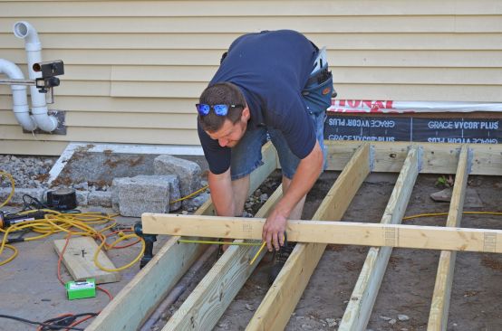

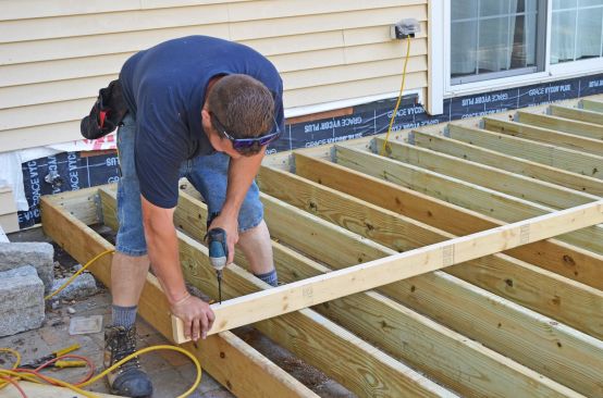

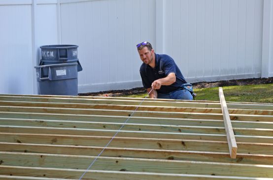

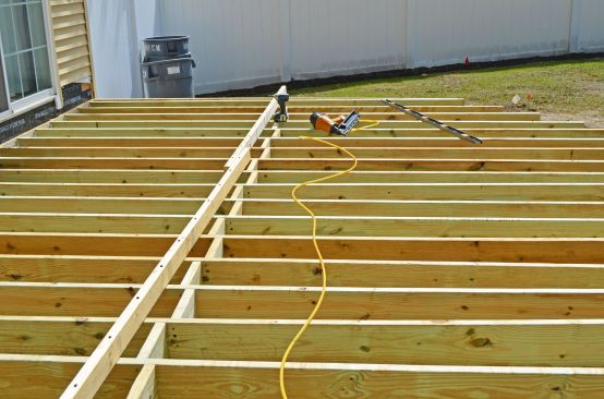

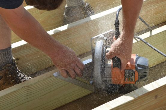

One minor deck problem has irked us for years: The finished surface of our decks was always a little uneven, and our synthetic decking often squeaked under foot. We use #1 treated lumber for our joists, but even these are often slightly warped and vary in height considerably, at times causing adjacent joists to differ in height as much as 1/2 inch or more.

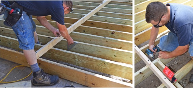

Our carpenter, Eric Roberts, devised a simple, elegant solution. Setting the joists perfectly level at the house is easy, and the beam makes them fairly even near the front edge. The problem lies in the middle. Before installing the mid-span blocking, he laid a straight 2×4 on edge, across the deck and perpendicular to the joists, as a sort of a strongback. He then twisted 6-inch TimberLok or HeadLok screws through the 2×4 “ridge” into each joist below. The screws pulled all the joists into a common alignment, flush to the bottom of our straight 2×4. In 20 minutes, our deck joists were perfectly level and in plane.

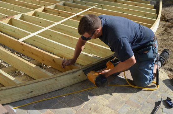

To preserve that consistent, level height, we nailed mid-span blocking in place and secured each piece tightly with 4-inch TimberLok screws, two at each end.
We removed our “Roberts Ridge” when we were ready to begin decking. A little movement and some squeak were noticeable in the frame, but installing the decking (especially because we installed it diagonally) eliminated that. So we were able to level the deck, reduce deflection, and virtually eliminate noise—all in a few minutes, and just with a temporary 2×4 and a handful of screws.

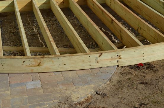

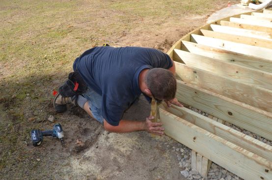

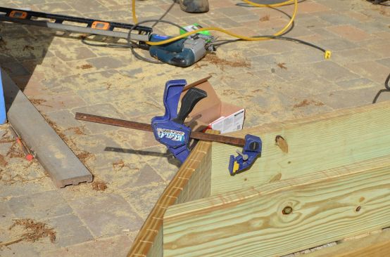

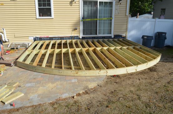

Cutting the Curve

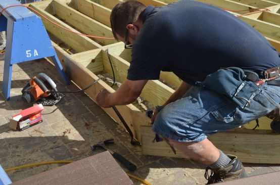

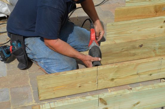

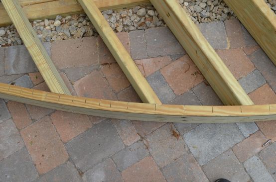

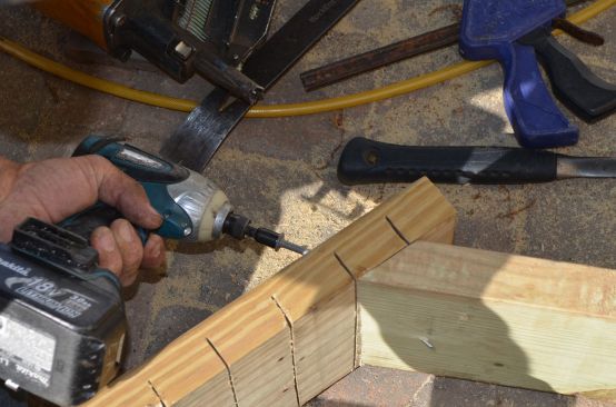

Since we had separated the beam structure from the edge of the deck, building a smooth, evenly curved rim became easy. We marked the curve on the joists using a string-and-pencil compass and cut the joists to length, finishing each cut near the ground with a recip saw.

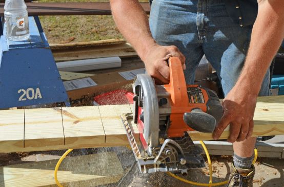

Carefully selecting and scoring the rim joist was crucial to creating an evenly curved deck. The rim joist could have no large knots, and a smooth curve demanded evenly spaced relief cuts. But the long radius (11 feet 6 inches) allowed our rim joist to easily bend into shape. Clamps on the ends and two screws in the middle held the curved rim in place. Leaving the joists loose over the beam allowed us to adjust any joist left or right until it tightly contacted the rim. We then aligned the height and nailed the rim to each joist.

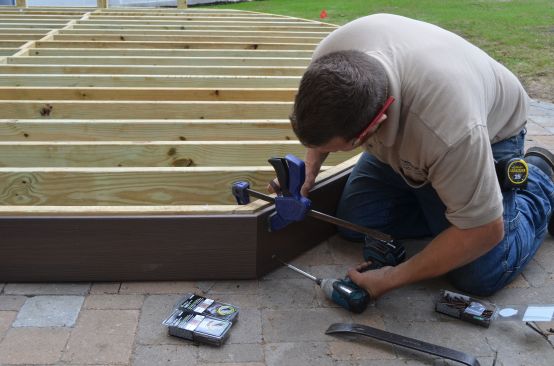

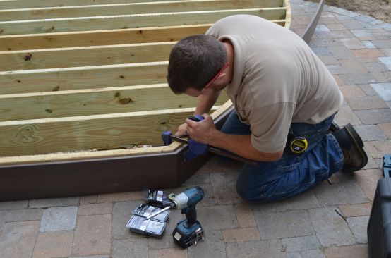

Trimming the Deck

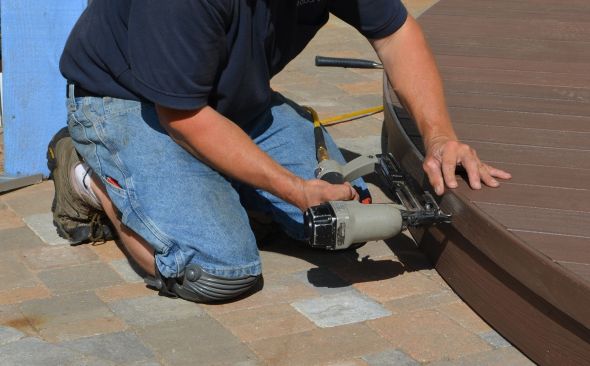

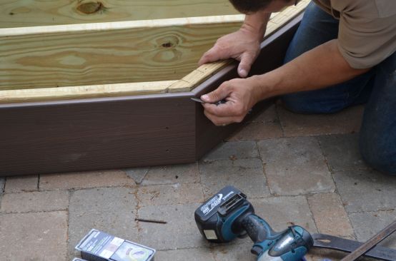

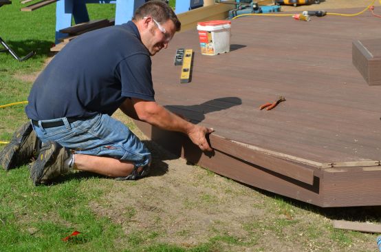

To hide the framing, we covered the rim and side joists with more Fiberon trim material. At 3/4 inch, it was thin enough to easily follow our curved rim joist.

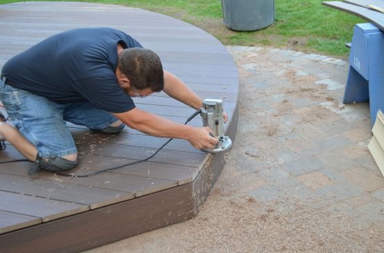

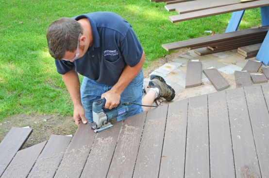

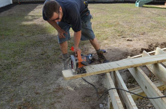

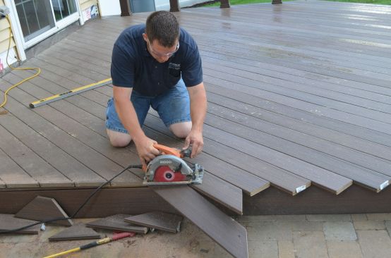

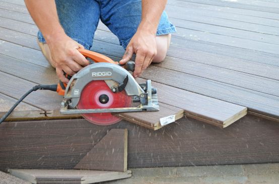

For decking, we used grooved Fiberon ProTect Advantage 5/4×6, fastened with hidden clips. We ran the deck boards diagonally and left them long, hanging past the trimmed rim. Cutting the decking straight along the side trim was easy using a circular saw.

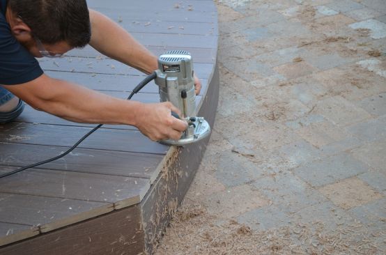

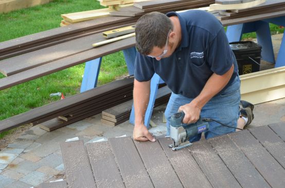

Cutting the decking around the curve took two steps. We first used a jigsaw to roughly cut each board about 1/4 inch beyond the trim. We finished the curve with a router and a 1/2-inch-diameter flush trim bit. The bit’s bearing ran smoothly along the curved deck trim and guided the blades to create a flush, even edge.

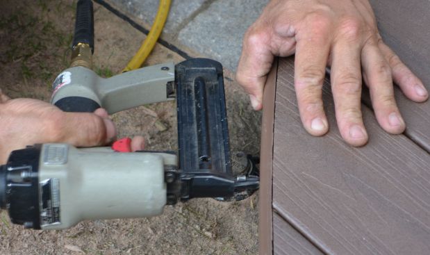

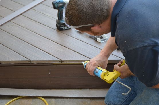

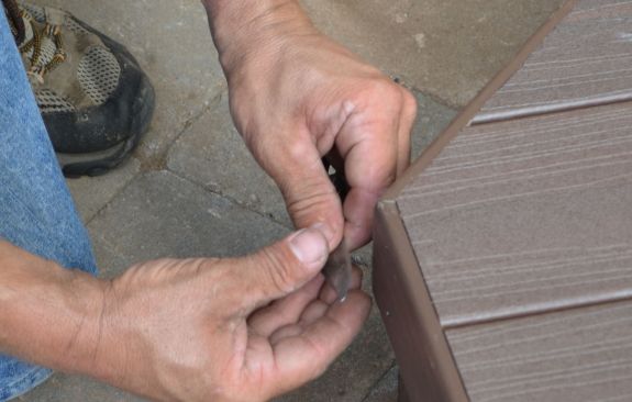

To hide the exposed ends of the decking, we installed a second trim piece, flush with the top of the decking. We ripped the same fascia material to 2 1/2 inches and fastened it with stainless steel trim nails through the lower trim, and with clear silicone and stainless steel pin nails into the ends of the decking above.
The diagonal decking left one small sliver that demanded some care (and an extra face screw), but the results were worth that effort.
Our completed deck looks simple. But making it solid, flat, and quiet, and ensuring that its curve was smooth and even, took some craftsmanship.
