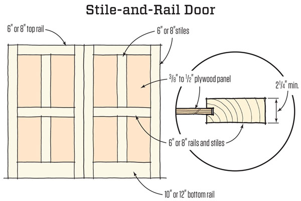

Q. I need to build three pairs of swinging barn doors to fit 8x7 openings. I'm looking for suggestions for a lightweight but sturdy door that won't fall apart. My approach was a sheet of 3/4-inch mdo with an applied 5/4 stile-and-rail effect. My main concern is the weight problem. Can you recommend any other approaches?
A.Finish carpenter David Frane responds: It's tempting to use plywood to make big doors, but, unfortunately, it (even mdo) won't stay flat when exposed to the weather. Here are three other ways to make doors the size you want:
The best way is to make real stile-and-rail doors. But that requires skill at joinery and better stock than you can get at most lumberyards. For doors this size, I'd want stiles and rails that were a minimum of 2 1/4 inches thick. You'd have to start with thick, dry material and use a jointer and planer to straighten it and bring it down to size. The panels could be 3/8- or 1/2-inch plywood. This will give you the best doors, but they'll be expensive and time consuming to build.
