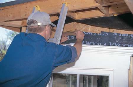

Sticky stuff. As long as the surface is clean and warm, rubberized asphalt sticks to a wide variety of substrates: dimensional lumber, plywood, steel, aluminum, hard vinyl, asphalt felt, and plastic housewrap (Figure 2). Some manufacturers of rubberized-asphalt flashing advise that their products may not stick well to concrete, masonry, or OSB unless these substrates are first primed.
Figure 2. Rubberized-asphalt flashings, like Grace’s Vycor Plus, stick well to unprimed plywood. Some manufacturers of rubberized-asphalt flashings warn that adhesion to OSB can be difficult unless the OSB is first primed.
