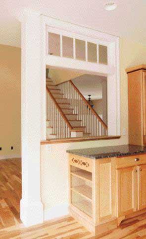

I think that cost-effective finish work today is really about knowing how and where to integrate new or nontraditional materials. There was a time when I used only natural wood for all my casings and finish trims. Now I actually choose MDF over wood because it's better for painted trim — with the money I save, I splurge on hardwoods for areas that call for a strong first impression.
Using MDF for most of the trim leaves room in the author's budget to use attractive figured hardwoods in high-visibility areas like sills, window seats, and other built-ins.
