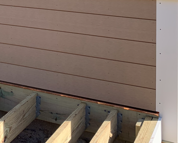

The author applies ice barrier membrane to the wall prior to installing the ledger board, then runs joist tape on top of the ledger and joist prior to installing the ledger cap.

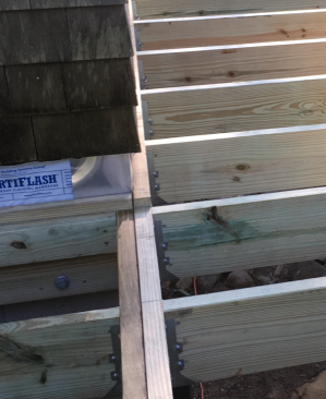

The author uses a ledger board one dimension larger than the joist size and drops the joists so the deck boards align flush to the top of the ledger.

I start the layout by marking the top of each joist on the ledger. For 5/4 composite decking, I snap a line approximately 1 ⅟₁₆ inches down from the ledger’s top edge and install joists so their top edges align with that line. This creates a flush plane between the finished decking and the top of the ledger.
For 3/4-inch decking, I drop the joists 3/4 inch below the ledger top. I also maintain a ⅛-inch gap between the final deck board and the ledger cap to allow for drainage. Once siding is installed, about 3/4 inch of the ledger flashing remains visible.

I start with joist tape, which a lot of builders today use on deck framing. When doing so, I not only run the tape along the top edges of the joist, but also run it up the ledger and then up the wall behind the ledger cap. This bridges the joist-to-ledger joint and helps direct water away from the joist end grain. I also run tape down the top edge of the ledger.

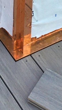

The finished result: The copper ledger cap aligns with the top of the decking. (Note: The copper corner flashing is a different detail that will be addressed in a coming article.)
My preference for a ledger cap is copper flashing for durability and appearance. In my experience, plastic ledger cap doesn’t hold up well over time. Regardless of fastening method, it tends to become brittle, and cracks or deforms over time. Galvanized metal may perform better by comparison and is serviceable in many applications, but in high-exposure areas—including coastal areas like here on the Cape or anywhere with persistently wet conditions—I view it as a long-term weak point. In addition, unlike plastic and copper, galvanized ledger cap is not an off-the-shelf offering in my area. Copper has proven to be the most durable option in wet environments, which is why it remains my go-to.
I install the ledger cap over the ice-barrier membrane and atop the ledger so it gets lapped by housewrap and siding. I leave a 1/4-inch gap between the bottom of the siding and the ledger cap to prevent moisture wicking.
