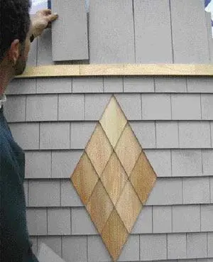

A diamond is a common shingle pattern; it can be as small as a single shingle or it can fill an entire wall. In this example, I'll create a diamond accent measuring about 15 inches wide by 30 inches high using point (also called diamond) shingles.

Before getting started installing the shingles, it's a good idea to lay out your first diamond designs on a flat piece of plywood to see how the system works. This will give you a feel for aligning courses and for making the transition from growing the base to closing the top of the design.
After you get the knack, you'll be able to build diamonds right on the wall when laying up field shingles, without missing a beat.
Also, it's easy to misplace fasteners when applying point shingles. To make sure that fasteners are located where they'll be covered by the diamond shingles above them, I make a cardboard jig with a ‘V' cut out and mark every diamond shingle with white chalk. This may seem like overkill, but it takes only a few seconds to mark a series of shingles, and it saves ripping a couple off later because of mislocated nails.

I start the pattern by dropping a pair of point shingles out of a shingle course so that their points align with the bottom edge of the course below. Doubling up the shingles in the bottom of the diamond gives proper ‘weight' to the base of the design. Then I install the remaining field shingles in that course.

To build up the diamond pattern, he installs additional point shingles at each course, using a framing square to align them with the point shingles in the previous courses.Note the V-shaped outline drawn on the shingles, which indicates where it is safe to drive fasteners.
On the next course, I drop two point shingles down, aligning the tip of each point with the shoulder of the point shingle in the course beneath and the shoulder of the point shingles with the field course shingles. A framing square helps to orient the shingles so that they're plumb.
On succeeding courses, I drop more point shingles down, installing them in the same manner until the diamond has grown to the desired width. In this project, I stop after the third course.
Before starting to close the top of the diamond, I install sideways ramp shingles on either side of the last pair of point shingles. These allow the next shingle course to smoothly transition up and over the design.

Over the ramp shingles, I install reverse-point shingles — which are used to close the diamond pattern back up — infilling between them with point shingles. To finish up the diamond, I use a pair of reverse-cut shingles at the top of the design.
To finish the diamond, the author fastens the final point shingle between a pair of reverse-point shingles.
Then he installs the reverse-point shingles that close the top.
After the pattern is completed, the remaining courses of field shingles are installed. To emphasize the shingle pattern, I've left the point shingles in this example unfinished. But usually I prefinish pattern shingles on both the fronts and backs, as well as along cut lines, before installation.
