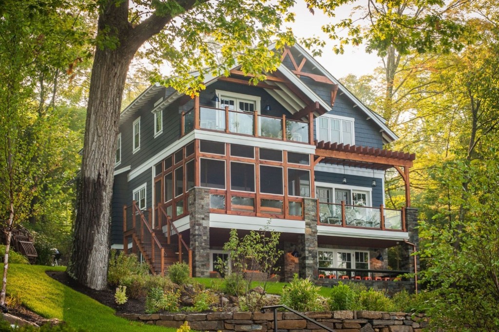

Smart design and material choices can transform an outdoor space into a high-performing extension of the home. The best designs respect the site, anticipate use patterns, coordinate materials, manage utilities, and create seamless transitions that make people forget they’ve stepped outside.
The first piece of advice is to design with the site in mind. A deck that cooks in the afternoon sun won’t get used much. And if the view is away from a water feature, the client will feel cheated.
Issues like these are why architect Edwin C. Anker of Phinney Design Group in Troy, N.Y., insists on a detailed site analysis. “We’ll design around a single tree if it matters to the homeowners,” he says.
His team requests a topographic survey, and they walk the property to understand light, wind, and sightlines. Time spent upfront prevents expensive mistakes later.

Every professional we interviewed agreed that the highest-performing outdoor spaces are at least partially under a roof. Not a pergola. Not an umbrella. A roof.
“I can’t think of a project we’ve done that’s not somewhat under cover,” Mills says. Covered spaces feel like rooms. They can be decorated, lighted, heated and furnished, turning them into three-season rooms.
In many climates, screening is what makes the outdoor room usable for all of those three seasons. And if the budget permits, motorized screens offer a functional wow factor.
This is certainly true in upstate New York where black flies can make an outdoor space unusable in May or June. “We like the motorized screens that drop from the soffit,” Anker says. When retracted, they disappear. When deployed, they turn a porch into a room.
Mills’ clients want the same flexibility. Mills installs motorized Phantom screens on many projects. “It’s a fully open space, but when the bugs appear, you can enclose it with the push of a button,” he says.
