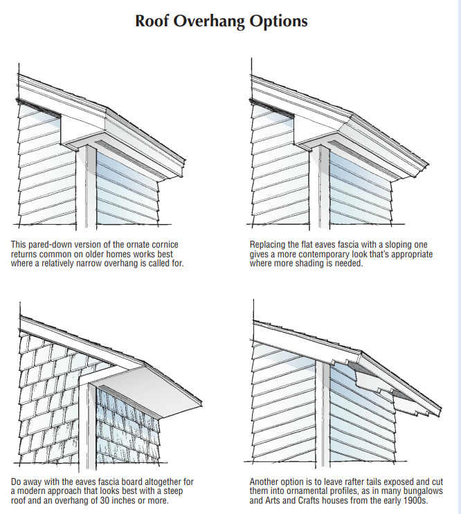

As illustrated above, simply select the appropriate “overhang factor” for your latitude and multiply it by the vertical distance between the windowsill and the lowest point on the overhang. The resulting dimension is the overhang distance that will provide complete noontime shade on the longest day of summer, and full sunlight on the shortest day of winter.
If there’s a lot of glass low on the wall, the required overhang may be several feet wide, making it a prominent exterior design element as well. That’s another issue, and one that can be addressed in any number of ways. The drawings below show some designs that may work well when a broad overhang is needed.
