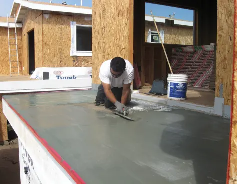

Desert Crete is a multilayer cementitious system whose main components are polymer modified cement and a fiberglass-reinforced acrylic resin membrane. The waterproof membrane is sandwiched between layers of the cement, which provides a tough and durable Class A and one-hour fire-rated traffic surface when installed to the manufacturer’s specifications.
That three-layer sandwich is then covered with a suitable finish material. If the framing below is sufficiently stiff, Desert Crete can be used as waterproofing under tile or stamped concrete. More typically, though, we apply a colored textured coating. Although the project described here involved new construction, we frequently install the product on existing decks provided that the framing and sheathing are in good condition.

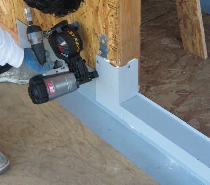

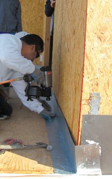

All flashings must lie tight to the substrate and have continuous support from behind. If the house isn’t sheathed — a common detail on older homes in this area — I’ll ask the GC to install horizontal blocking at the level of the wall flashing. Galvanized flashings are fastened with galvanized ring or roofing nails. Copper flashings can be fastened with copper nails or stainless steel ring nails. We prefer stainless fasteners because they are available for use in coil guns.

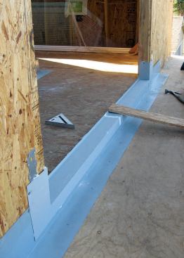

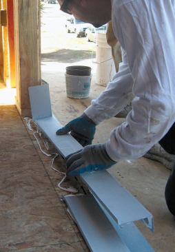

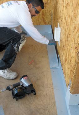

Door pans. Our first step is to install an L-shaped wall flashing below door openings and lap a sill pan over top. The horizontal leg of the wall flashing is 4 inches wide, and the 6-inch vertical leg is notched at the door opening so it finishes flush with the interior subfloor.

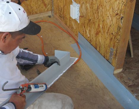

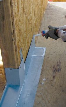

Although the sill pan could be made as a single piece, that would involve expensive custom work. Instead, we have the sheet-metal shop provide us with a simpler two-piece pan that can be adjusted to fit the opening. The two halves of the pan are installed over continuous beads of polyurethane caulk, such as Moistop Sealant (Fortifiber Building Systems Group, 800/773-4777, fortifiber.com), Sikaflex-1a (Sika Corp., 800/933-7452, sikaconstruction.com), or RainBuster 900 (Top Industrial, 800/473-1617, topindustrial.com). The pieces overlap one another near the center of the opening, and are fastened in place with nails driven through the vertical flanges and into the trimmers on either side of the opening, so there are no penetrations in or near the bottom of the pan.

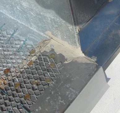

Flashing the perimeter. Once the door pan is in place, we install L-shaped flashings over the remaining joints between walls and deck. The horizontal leg is slit at inside and outside corners to permit the required bend in the vertical leg. All laps are sealed with double beads of polyurethane caulk.
The vertical leg of the flashing is fastened to the wall with a line of nails on about 8-inch centers, which are positioned just below its top edge to prevent leaks. Nails in the horizontal leg are placed 3 to 4 inches apart in a W-shaped pattern. Leaks in this area are not a concern because the nail penetrations are covered by the waterproof coating.

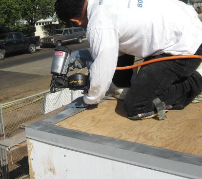

Finally, the open edge of the deck is covered with a low-rise gravel stop, which is a drip flashing that extends 3 or more inches onto the deck sheathing and 2 or more onto the fascia below. A 1/8-inch lip on top of this stop allows us to trowel an even thickness of the coating material all the way out to the edge.
