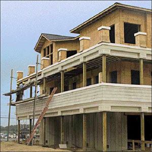

Deck durability begins with the house design. In hurricane zones, multistory decks over porches or integrated into the foundation footprint have a better chance of withstanding a major storm, while attached decks (inset) are more vulnerable to being ripped apart by storm waves and hurricane-force winds.
Decks and porches on beach homes take the brunt of any storm. Add to that the homeowners’ desire for low-maintenance finishes that stand the test of time even in a salt environment, and it’s clear that builders have to be especially fussy about their deck materials choices and installation methods.

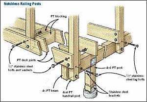

Rule 2: Never notch railing posts. The National Design Specification for Wood Construction, on which the model building codes are based, prohibits notching in the middle third of a post and limits notch depth to one-sixth the depth of the member in the outer thirds and one-fourth the depth at the very ends. This amounts to a notch of only 1/2 inch in a 4×4 and 7/8 inch in a 6×6 — hardly worth the effort. And even this notching weakens the post by as much as 40%.
If posts are notched, the cut should be coated with a preservative, such as copper naphthenate, which is yet another reason for avoiding notches altogether. Bean’s notchless railing details (Figure B) provide a lasting alternative. — Clayton DeKorne
FIGURE B. Rather than notching railing posts, the Southern Pine Council recommends sandwiching the posts between a double rim joist and through-bolting the connection as shown. On railings running perpendicular to the joists, space posts so that they can be securely bolted to the ends of the joist.

He says that the code requirements concerning wind uplift are straightforward. He simply has to take steps to securely anchor the deck structure, such as embedding galvanized straps in concrete piers and wrapping them over the deck beams.
However, when a major storm hits, the beach environment can create problems for conventional footings. “Everything we’re building on is beach sand, and if it gets waterlogged it acts more like water than sand,” he says. Because of this, some houses — and some raised decks — have to be built on piles driven deep into the sand. (Supporting the corners on piles and putting concrete piers between them is often sufficient.) Borden says that pile depth requirements for the deck are based on FEMA regulations, and are the same as for the main house. “In one house the elevation was 12 feet above sea level, so we had to drive the pilings 25 feet deep,” he recalls.
