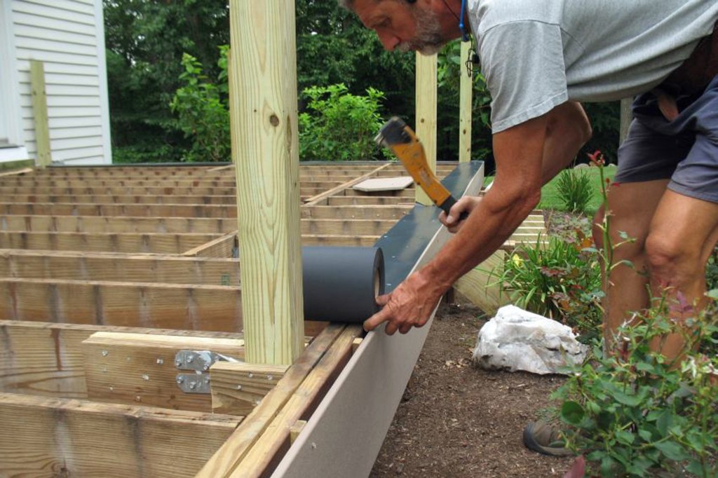

PT spacers between the fascia and framing and a membrane cap over the gap will minimize potential water damage to the rim joists.
Mike Guertin
