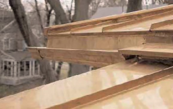

Figure 1. Miter joints stay tight only when temperature and humidity match the day they were installed. When the weather changes, miters tend to open up and allow water to get in and cause rot.

My rule of thumb is to avoid fancy joints when installing exterior trim. Although I do advocate using scarf joints for corner boards and rakes, I steer clear of laps and rabbets. While these more intricate joints can increase strength and alignment in cabinetry, in exterior work they decrease durability by increasing the surface area and complexity of a joint. Joint strength and alignment are not problems with exterior details. Instead, the main objective is to avoid nooks and crannies where moisture can sit and collect.

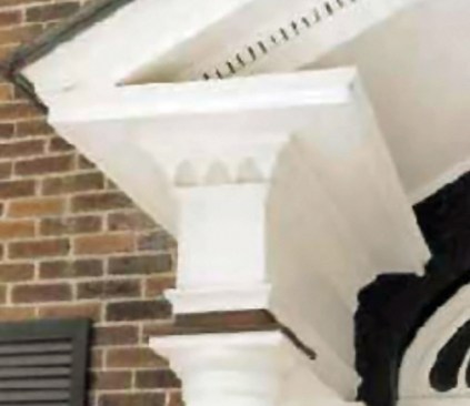

Miters should be avoided because they fit tightly only at the humidity and temperature conditions at which they were first installed. In my New England climate, this is perhaps 25% of the time. The rest of the time, the joint is slightly open and the endgrain soaks up moisture like a sponge (see Figure 1, above). Premature paint failure and rot result. Try using butt joints that don’t really butt — square ends with a 1/8-inch space between them. Spacing butt joints prevents water from getting trapped and will allow joints to dry out faster. Believe me, it requires as much skill and time to do a porch and stair with rigidly consistent 1/8-inch reveals between finish pieces as it does to do it with tight miters, so this should not be viewed as cheating. Furthermore, the 1/8-inch reveals will look good long after the “tight” miters are rotting and peeling.

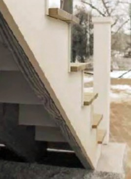

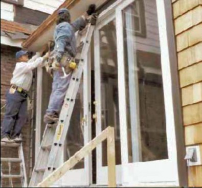

Figure 2. Avoid miter joints on porch and deck stair trim. Instead, run stair risers long and butt the skirt board into the risers.
There are also other trim-out tricks that avoid miter joints. For example, unlike interior stairs, which almost always have mitered joints between risers and an outer skirt board, the risers on a porch stairway can run long past the skirt (Figure 2, right).

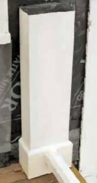

On corner boards and other wide trim, it’s important to craft vertical and horizontal intersections in ways that prevent moisture from penetrating and getting trapped behind the exterior surfaces. I’ve found that stopping a vertical corner board on top of a properly flashed skirt board makes for a more durable detail than the other way around. With this detail, it’s important to keep a 1/8-inch space between the bottom of the corner board and the skirt flashing. A shallow back-cut will also help prevent wicking of moisture. The problem with corner boards that run down past the skirt is that water ends up getting into the butt end of the skirt. From there, moisture soaks the sheathing and creeps upwards.

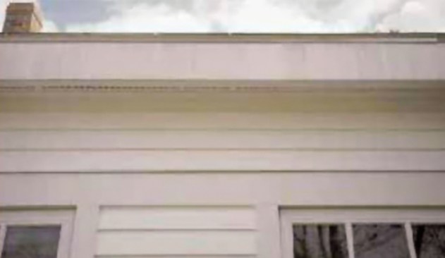

Figure 3. The deep eaves on this remodel give extra protection to walls and windows beneath.
Eaves and gutters. Always try for deeper eaves and rakes — 8 inches at a minimum — to help prevent water from sheeting down exterior siding (Figure 3, at left). Drip edge should also be spaced about 1/4 inch off the fascia to keep water from running down the fascia and discoloring it (Figure 4, below). Adding a second molding along the top of the fascia can help position drip edge even further outwards. Although it goes against what some people want to see, an even more durable design detail is to cut rafters square instead of plumb to lower the chance of roof runoff draining onto fascia boards.

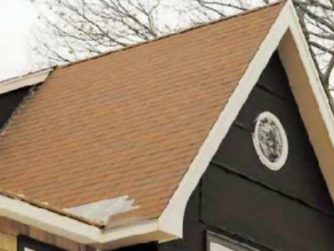

Figure 4. If drip edge is installed too close to the fascia, rain runoff will drain over the boards and lead to discoloration. The author recommends spacing drip edge slightly off of exterior trim to direct water outwards.
Finally, install gutters so that there’s no way for water to run between a gutter and the fascia. Use flashing rather than caulk to bridge this gap (Figure 5).

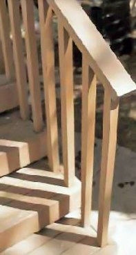

Exterior living spaces must be detailed differently from interiors because everything must shed water and dry easily. If you install a pine baluster so that the bottom end butts tight to the bottom rail and the assembly is exposed to weather, I can almost guarantee that within five years you will be able to put your thumb clear through the bottom 2 inches of the baluster. A few subtle design changes can keep baluster bottoms relatively dry, such as running balusters through the decking or setting them onto a chamfered bottom rail (Figure 6). If you can’t detail the railing to avoid a horizontal butt joint, soak the ends of the balusters in preservative or coat them heavily with primer before assembly.
Figure 6. Running balusters through the decking is one way to avoid deterioration of a bottom rail.
Chamfering the edge of the bottom rail so they don't hold water is another common way to stave off deterioration.

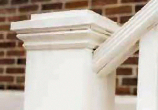

You also have to be careful where sloping top and bottom rails hit a newel post. Although there is no way to entirely prevent moisture from collecting at this junction, there are ways to minimize the problem. First, avoid rails that are wide and flat on the top side. Secondly, if you’re wrapping a post with trim boards, avoid running the rails through to the structural newel underneath, because water will also run through and become trapped in the void between the wrapping and the newel (Figure 7). Also make sure to adequately prime and coat the end of the rail to prevent excessive wicking of moisture.

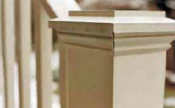

Wide and flat or minimally pitched surfaces — like wide railings, wall caps, or newel caps — also present problems. My rule of thumb is to use metal flashing whenever the wood is wider than 51/2 inches. For example, I run a piece of flashing completely over column caps (Figure 8).
Figure 7. Prevent water penetration where rails join newels by adequately priming the end cut of a rail. It also helps to avoid rails that are wider than 51/2 inches. When newels posts are wrapped, butt the rails directly against the trim instead of running rails through to the post where water will get trapped.

Figure 8. Flat surfaces are especially susceptible to water damage. To fend off problems, the column cap here is completely capped with metal flashing, and the eaves return is also extensively flashed.
