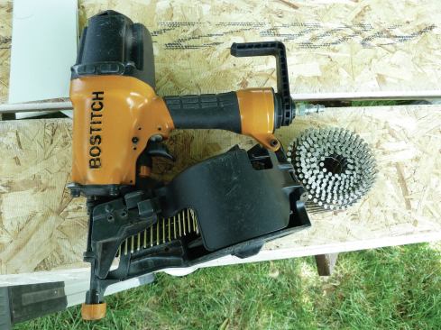

A coil siding nailer is a must for fastening denser siding or trim products. Most shoot nails in lengths from 1 1/4 inches to 2 1/2 inches (5d to 8d), and a few can fire 3-inch (10d) nails.
Sue Burnet
A must-have feature for engineered siding is an adjustable depth of drive on a pneumatic nailer; many nailers have a thumb wheel for this purpose. This practically eliminates the need to leave the work area to adjust your compressor’s regulator. Use no-mar rubber or plastic nosepieces to reduce the risk of damaging prefinished material.

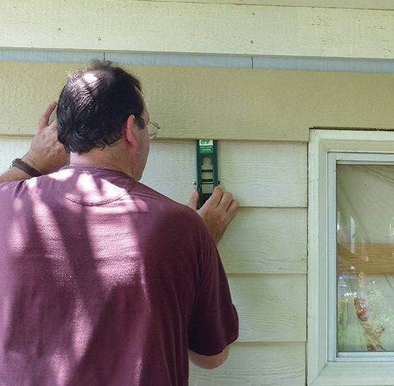

The stud spacing behind engineered siding should be no more than 16 in. on-center. If codes permit, the siding can be fastened directly to the studs without sheathing.
Make sure that all vertical butt joints fall over stud locations.
Leave a 3/16-inch gap where the siding meets a window, door or vertical trim piece. Caulk the gap with a sealant.

As with other horizontal sidings, the first course must be installed over a starter strip. Unlike taper-sawn wood clapboards, however, most engineered siding is the same thickness across the width of each board. So for the starter strips, rip a length of the material into 1 1/2-inch widths.
