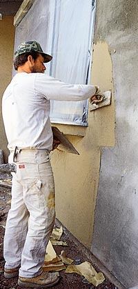

In the West, a steel trowel is used to produce an adobe look when the brown coat is the final coat. Once applied, the two coats should be allowed to cure, or rest, for at least a week, preferably two, before applying the finish coat. This allows the scratch and brown coats to strengthen, settle down, and do all the cracking they intend to do. After this curing period, the finish coat can be applied (Figure 2).
Figure 2. The 1/8-inch-thick finish coat is applied with a trowel.
