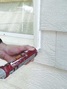

Aluminum/Cement Conflict
Portland cement is highly alkaline and can corrode most unprotected aluminum. The exception is anodized aluminum. Most manufactured aluminum window trim is anodized; most off-the-shelf aluminum flashings are not. As a precaution, prime the ends of fiber cement siding at field cuts near flashings or aluminum windows.

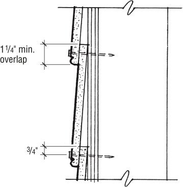

Nailing Checklist

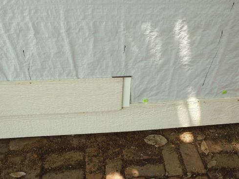

  • Narrow and regular siding panels – up 9 1/2 in. wide – should be blind nailed by hand or with a nail gun. Use wide-head roofing nails (.121-in.-shank with a .371 head diameter) or siding nails (.09-in. shank with a .221-in. head diameter). Place nail between ¾ and 1inch from the top of the panel.
  • Wider panels must be face-nailed at the bottom edge with siding nails. Do not nail closer than 3/8 in. from edge of a panel.
  • Use only corrosion-resistant roundhead nails (not clipped-head nails or staples).
  • Fasteners must penetrate 1- to 1 1/4-in. into framing.
  • Do not overdrive fasteners. The siding is only 5/16 in. thick, so setting nail heads below the surface decreases holding power and voids the warranty.
Note: Dimensions may vary from product to product. Be sure to check the manufacturer's ESR for the particular fiber-cement siding product you are installing.
Figure: Blind Nailing Fiber-Cement Siding
Figure: Face Nailing Fiber-Cement Siding

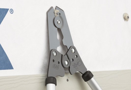

Removing Fiber-Cement
Malco Products
Hidden-nail clippers are available for cutting the nails behind boards so they can be removed. You can also use a metal blade on a reciprocating saw, but you risk damaging the housewrap. Replacement panels must be face-nailed.

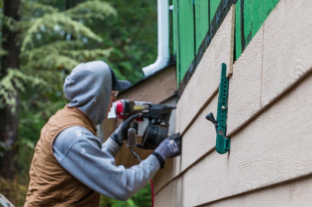

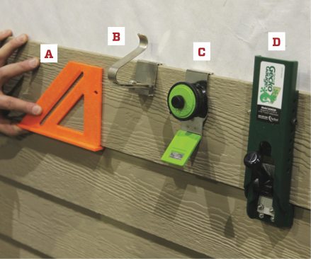

Gauges for Installing Siding
There are dozens of different gauges; four are shown in the photo above. Gauges can be as simple as a plastic framing square cut to the size of the siding reveal (A). (We label ours with their size and store them
in a bucket for future projects.) The second gauge (B) is preset to the size of the overlap and slips over the top of a siding course to hold the board above in place, allowing one person to install long lengths. The third one (C) also slips over the top and lets you dial in the size of the reveal. The fourth gauge (D) clamps to the bottom of the course below. It adjusts to the size of the reveal and locks in place with a lever.
Roe Osborn There are dozens of different gauges; four are shown in the photo above. Gauges can be as simple as a plastic framing square cut to the size of the siding reveal (A). (We label ours with their size and store them in a bucket for future projects.) The second gauge (B) is preset to the size of the overlap and slips over the top of a siding course to hold the board above in place, allowing one person to install long lengths. The third one (C) also slips over the top and lets you dial in the size of the reveal. The fourth gauge (D) clamps to the bottom of the course below. It adjusts to the size of the reveal and locks in place with a lever.

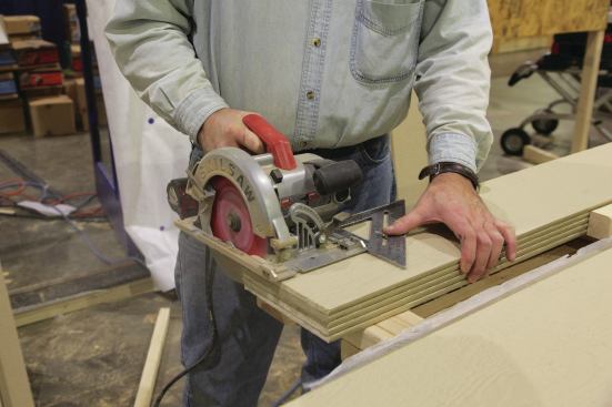

Cutting Fiber-Cement
For cutting fiber-cement siding, it's best to use a 4- to 6-tooth polycrystalline diamond-tipped (PCD) blade made specifically for fiber-cement.
Regular carbide blades will cut fiber cement, but they dull relatively quickly, and if you attempt a gang cut, the blades overheat and can warp.

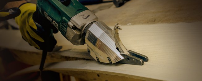

An alternative is electric shears, which work like motorized tin snips. While they are slower than a circular saw, they can make straight and curved cuts without much dust.

Cutting fiber-cement with a circular saw produces serious clouds of dust. This dust has a 15-30% crystalline silica content, making it a serious health hazard. The MSDS of one popular fiber cement product warns that repeated inhalation may lead to lung damage, and the National Institute of Occupational Safety and Health (NIOSH) links the inhalation of silica dust to a deadly lung disease called silicosis.
When cutting fiber cement, it's critical to wear a respirator and/or use a dust-collecting circular saw attached to a shop vac. NIOSH recommends:
  • A saw with a built-in dust collection container or shroud that partially encloses the saw blade.
  • A shop vacuum with an air-flow rate of 30 CFM or higher.
  • A hose that's at least 1.25-inch in diameter with few or now bends.
  • Use of a high efficiency disposable filter bag a pre-filter in the shop vac.
  • Use of PCD blades.
