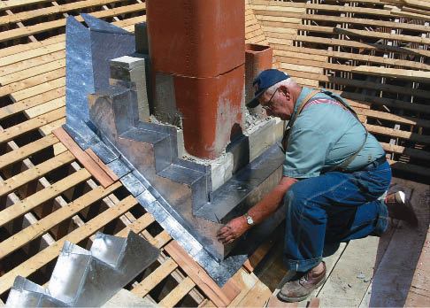

The tinsmith and the mason have to work together to develop a practical and visually pleasing design for the chimney. Our flashing intersects the masonry in stepped shoulders that follow the roof pitch. The steps continue around the back of the chimney, climbing the slope of the cricket. To guide the forming of the steps in the masonry and the fabrication of the various flashing parts, we make patterns out of tar paper. The mason follows the patterns to build the base contours, then withdraws for a couple of days while we prepare and install the flashing.
For accuracy, we trace new patterns from the completed masonry shoulders before making the flashing. We transfer the patterns directly onto the copper using a steel square and a scratch awl, adding lips and overhangs as needed.
To achieve a strong soldered joint, the materials must overlap — not just butt — so the heat can draw the solder in between the two surfaces (anyone who has ever sweated copper pipe knows this). That means you have to plan your cuts so you leave extra overlapping material for the joints. In some cases, a 3/8-inch or 1/2-inch overlap is sufficient. But at corner joints, which are likely to be stressed more from movement of the metal, we leave extra material so that we can make a folded seam; it too gets soldered.

Once we’ve cut out the stepped pieces, which look like stair stringers, we use them to make patterns for the corresponding inside steps — the parts that run through the masonry on all four sides. These are cut and folded accordion-style in one-piece sections. The horizontal steps insert 6 inches into the chimney, covering the tops of the masonry steps. They have a 2-inch upturned leg on the inside to catch any water that comes down between the chimney liner and the masonry.
The components are assembled facedown on the bench and fully soldered from the back. We use a soldering technique called “lacing,” which involves moving the torch back and forth in such a way that we can gradually feed the solder and build a smooth seam.
As every builder knows, any time you cut and fold a piece of bent flashing, you lose material at outside corners. The nice thing about soldering is that you can make a seamless patch to fill in the missing material, which we do on the outside corners of the steps. Inside corners overlap, so we clamp them tight and solder them.
Base Flashings First
The components are carefully brought to the roof and assembled on the chimney for soldering. The base flashings — the parts attached to the roof but not the chimney — are installed first. These include the front apron — a simple folded piece with soldered outside corners — followed by the step flashing up the sides and the cricket at the rear. The two sides of the cricket are joined at the ridge with a folded, watertight seam, like the one used for standing-seam roofing — the only seam that doesn’t have to be soldered. The first bends of the seam are formed on a brake, then completed in place on the roof with a hand seamer — a pliers-like tool with wide, flat jaws — and a rawhide mallet, which flattens the fold with minimal marring of the copper.
We fold and solder the outside corners where the cricket laps over the step flashings as needed to make them watertight.

Next come the counterflashings — the pieces that are attached to the masonry but not the roof. They lap the upturned legs of the base flashings very snugly but still allow for differential movement between the roof and the chimney mass.
We install the right and left stepped sides first, then the rear steps, which overlap at the center and are soldered as a unit. The apron counterflashing goes on last. We use a locking hand seamer to clamp it to the overhanging metal of the side steps at the front corners while it gets soldered on top. Then we fold the corner overhangs into seams — again using the seamer and mallet to tighten the flashing around the corner — and solder the corner seam. Before soldering, we make sure to clean the copper once more with a wire brush, then with the acid flux. If the job is done right, the molten solder is drawn almost invisibly into the joints by the heated metal; very little is seen on the finish side.
The last step in the process is to provide weep holes. These are inverted copper vees with notched edges that gather water and channel it to the surface. They’re about 6 inches long and are lightly solder-tacked to each shoulder so they can’t be dislodged by the mason.
