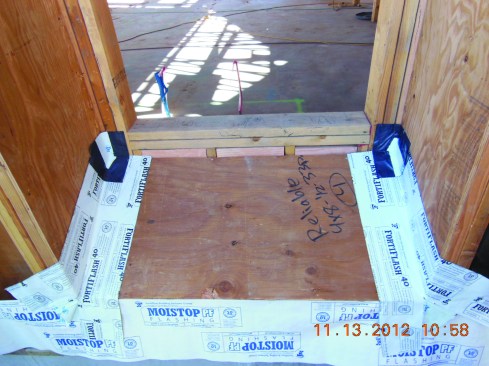

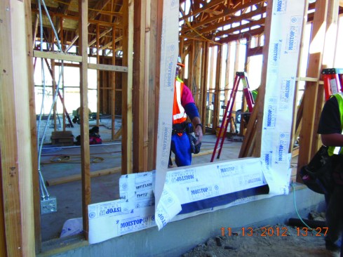

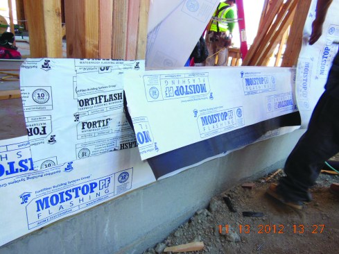

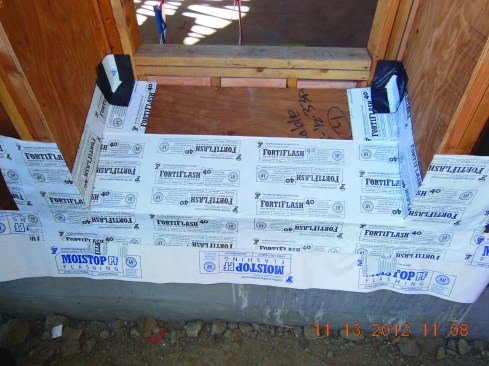

Recessed windows are used as step stools and are also often damaged by tools and materials that are passed in and out of the opening during construction. For this reason, the author calls for installing an extra layer of black paper on the bottom area of the recess.

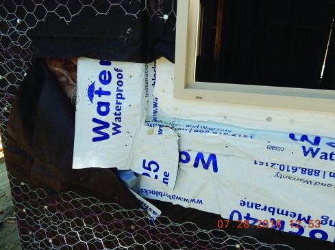

This window was torn apart after the windows on a new home started leaking. Without a good flashing design provided on the plans, the installers simply applied peel-and-stick to the outside face, without bothering to first bend pieces into the corners or use pre-fit flashing corners.

Poor “origami.” Leaks due to the complex cutting and folding of the waterproofing materials are common. Let’s face it, cutting and folding sticky, thick material is no easy process. Even the most experienced guys will struggle. Towards the end of a day, the temptation to simply “karate chop” the materials into place often takes over.
Damage from trades. The recessed edges of the openings are vulnerable to abrasion from tool bags and heavy building materials being passed through. We’ve also observed trades using the lower edge of the windows as a step stool (1) and as a tool locker. The lower edge is often damaged by the heavy, steel-toed boots of tradespeople climbing through the opening or reaching up onto the wall.

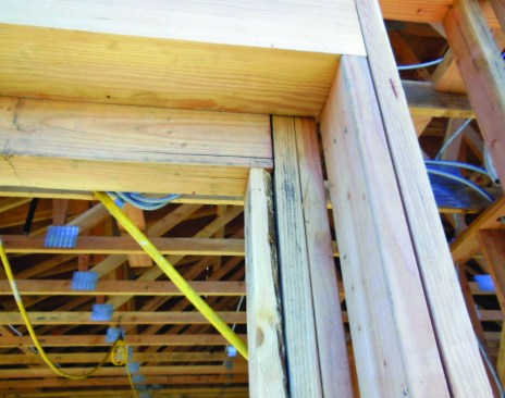

No shiners, no wane. It is difficult for tradespeople to know where the backing is after the weather-resistive barrier (WRB) has been installed. If the home is fully sheathed, do not allow excessive gaps between sheathing panels. Gaps should be only 1/8 inch wide, or the width of the shank on a 16d nail. Gaps larger than that not only leave a void behind any membrane applied over the gap, but are also a magnet for shiners (nails that miss the framing) . Make no mistake about it: Shiners usually leak.

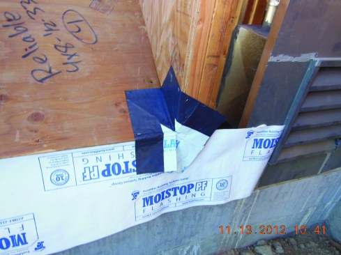

The lumber used to pack out this recessed window opening will be covered by the weather barrier and flashing tapes, so the trades that follow will have no way of knowing there’s a major void in the backing due to wane along one edge. A lath or trim nail puncturing the flashing over this void would more than likely leak.
Also, never allow waned lumber to be used as backing in the recessed opening (3). Face all waned lumber to the inside, where it may give the drywall installers a headache, but won’t create an expensive leak. When facing the outside, wane creates huge voids behind the flashing membrane. When subsequent trades—stucco lathers or the exterior-trim crew—come through, their nails will not self-heal against a void and will result in window leaks.

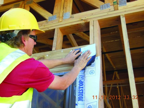

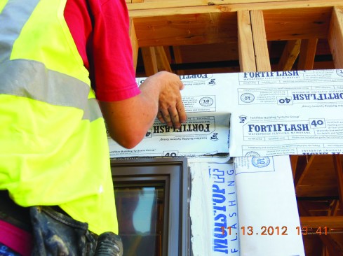

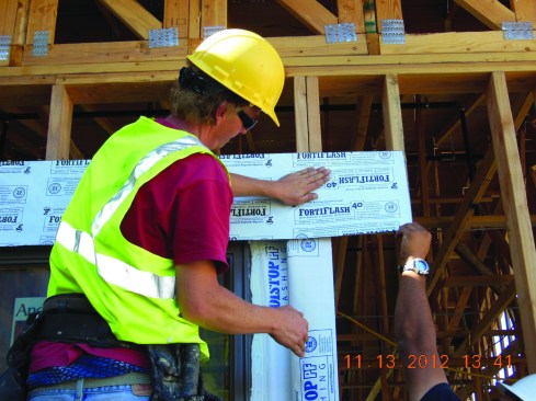

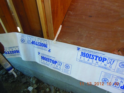

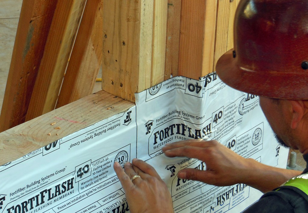

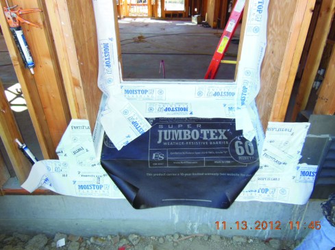

Work from bottom to top. This is obvious to a lot of folks but bears repeating. You have to work from bottom to top to make sure top layers lap over bottom layers.

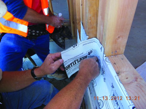

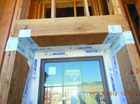

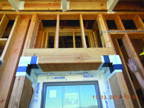

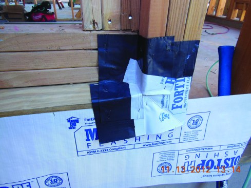

Pre-formed flashing corners. Pre-formed corners are available from Fortifiber. They’re sold as “Corner Flash A” (for the outer corners of the recess) and “Corner Flash B” (for inside corners). But you can also pre-form corners using DuPont FlexWrap or other flexible flashing material following the DuPont instructions.

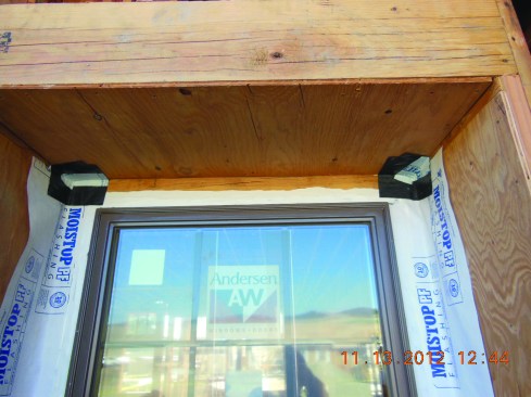

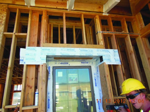

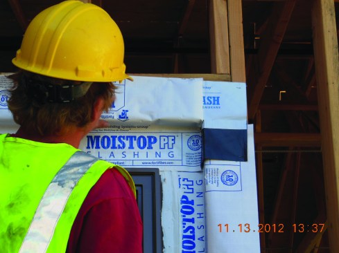

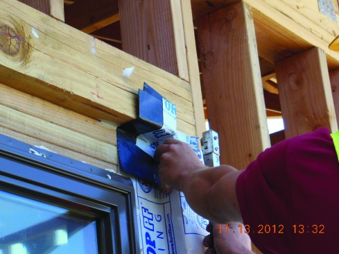

Use flashing corners on all corners of the recessed opening, including the four outside edges of the outer face of the opening, as well as the four corners on the wall area in which the window is set. On the bottom of the opening, the corners on the outside edge are installed first, then the corners near the window unit. On the top of the opening, the inside corners near the window are installed first, then the corners on the outside edge. This will ensure that the layers are lapped correctly.
And don’t forget the top corners. A lot of folks are so concerned about the lower sill area, they neglect the top corners of the opening. Those are just as susceptible to blowing rain and water dripping around the top edge and running into a tiny gap.

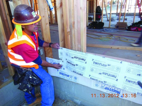

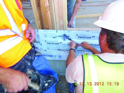

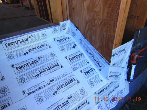

Protection layer. After the lower recessed edge is correctly flashed, apply a course of building paper to protect this important area from trade damage. Many times, recessed openings are used as tool-holders and stepping stools, which will damage your carefully applied and expensive flashing efforts. Adding a course of building paper or a sheet of nail-on flashing is a cheap insurance policy.
J-roller. The karate-chop method of pushing peel-and-stick into a corner is not enough. Alway use a J-roller to smooth the material flat and ensure complete adhesion. Wrinkles and poor adhesion will inevitably lead to leaks.
