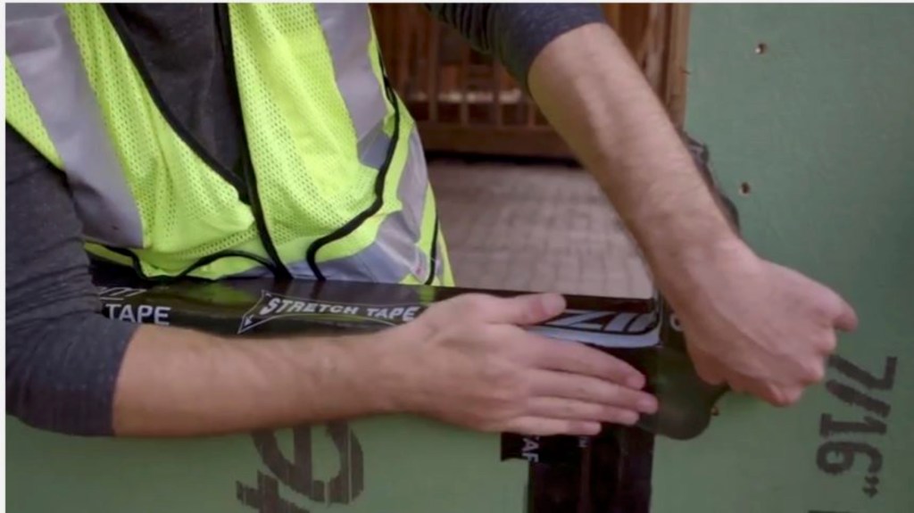

One And Done Sill Pan Solution
Traditionally, flashing a windowsill can require some special origami skills. Applying individual tape segments to corners to ensure a continuously sealed surface can be tedious. Ben recommends 6- or 10-inch ZIP System™ stretch tape for the job. This stretch tape is a unique composite acrylic tape that stretches in all directions. All proper application requires to easily flash the entire pan, is a single piece of tape. In the first of a three-part video guide, Ben demonstrates adding 6-inches up each window jamb to create full coverage of the sill pan. Allowing a 2-inch of overhang down the front of the sill is also recommended.
Like all ZIP System tapes, ZIP System™ stretch tape is pressure activated. For best adhesion, roll over the tape with a J-roller for a tight bond. This will smooth out any wrinkles that may have been created in application and avoids “fish mouth” areas where water could creep in. While it has an aggressive bond when completed, the unique stretchy composition of ZIP System stretch tape allows it to be pulled up and re-applied. (Click here for a brief step-by-step video. LINK: https://www.youtube.com/watch?v=Qm-BRdqOJhQ)
Proper Shingling
Install the window using a butyl or silicone sealant, per the window manufacturer’s instructions. Then flash over the nail flanges with Zip System® straight flashing tape. Make sure that the jamb flashings overlap the sill flashing at the bottom of the window, to achieve a correct shingling pattern and avoid creating a window leak path. (Click here for a brief step-by-step video. LINK: https://www.youtube.com/watch?v=RGf4SbZXQcQ)
Finally, flash the head of the window. ZIP System straight tape also comes in 6–inch width that will give the best adhesion surface area and makes it easy to properly cover at least 2-inches above where the window flashing ends. Make sure this header flashing also extends at least 1-inch horizontally past your jamb flashing on either side. Again, rolling the tape with a J-roller helps activate the powerful acrylic bond and smooth out any wrinkles where leaks could occur during application. Be sure to seal the interior with a low-expanding foam. (Click here for a brief step-by-step video LINK: https://www.youtube.com/watch?v=4RZEnQjerAs)
