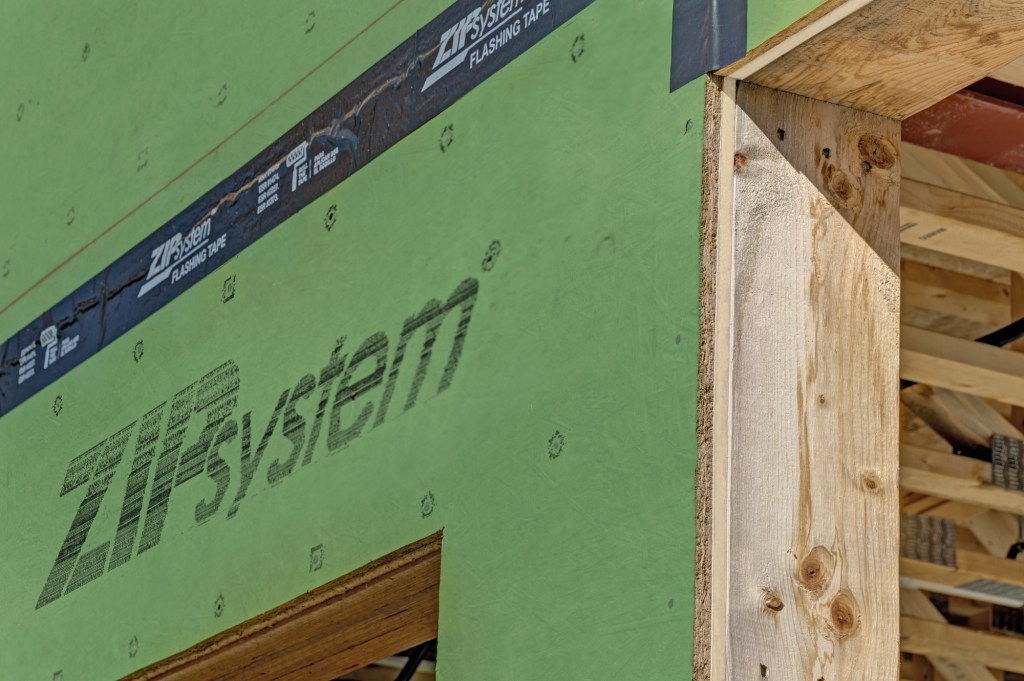

All-In-One Envelope Sheathing
Today a growing number of builders have identified a CI method that helps streamline the house wrapping process while solving thermal bridging in a single structural system.
The all-in-one structural panel system, called ZIP System R-Sheathing, consists of a water-resistive barrier and polyisocyanurate foam insulation layer manufactured onto the engineered wood panel that’s sealed with a high-performance acrylic adhesive tape system. The multi-layer wall system is engineered to save construction steps by combining weather, air, and heat resistance in the exterior envelope with enhanced drainage plane properties.
