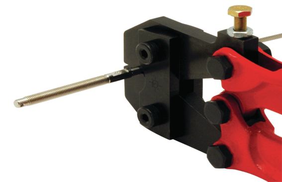

I use a simple stainless steel cable cutter to cut the 1/8-inch-diameter wire to length (you’ll ruin standard wire cutters if you try to use them to cut stainless steel cable). For final trimming, I use a right-angle grinder equipped with a Hilti metal cutoff wheel, since cable cutters won’t trim close enough to the fittings to accommodate the end caps.

Swaging isn’t difficult, however, and I sometimes cut my cable to length and attach the terminations on site. This is useful when there are many changes in direction, which would otherwise require a lot of short runs and a lot of fittings (the most expensive part of a cable assembly). I can string the cable through small, 3/16-inch-diameter holes, swage the terminations, and then tighten the cable from both ends.
Swaging sometimes makes the stud curve so that it looks a little like a banana. It can be easily hammered straight again with a rubber mallet, but I don’t think swaged fittings are as attractive as pre-attached terminations.

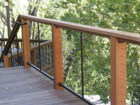

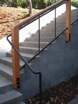

The most common cable-rail problem I’ve seen occurs when someone tries to convert a conventional balustrade with 4×4 wood posts, 2×6 top rails, and 2×2 pickets to a cable rail by removing the pickets, drilling the posts, and installing a cable kit. Because the compression created by the cables bears on the top rail, the post-to-rail connections, and the outermost posts, the outer posts will bow inward over time from the pull of the cables, even if the posts are well-attached to the framing and meet code. This will lead to an endless cycle of retightening cables and more post bowing.
When properly installed, however, wood posts are just as effective as metal posts, and I think no rail is more beautiful than a clear redwood or red cedar post system with cables. I won’t install cable on a 4×4 post, however; the posts must be 6×6 or 4×6, with the long dimension parallel to the cables.

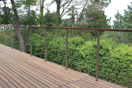

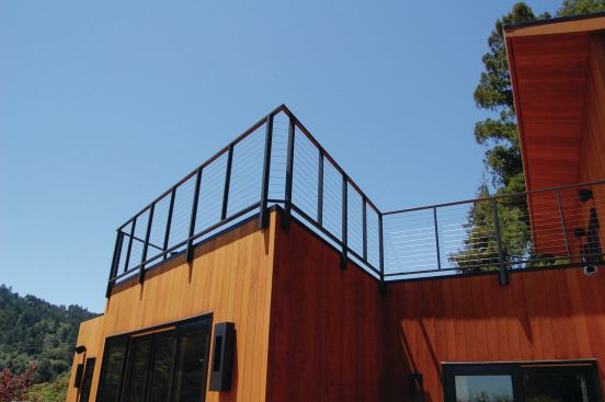

Metal. Many of my clients prefer metal posts, which are much sleeker at 2 inches square than 6-inch-square wood posts. I buy quantities of Allied Tube & Conduit’s Gatorshield from US Wholesale Pipe and Tube and use either round or square tube to fabricate most of my steel frames. Gatorshield is galvanized, but unlike most galvanized pipe, it has a smooth, multicoat finish that doesn’t need to be washed off or primed prior to painting, and that has proven to be durable and rust-free. I use it inside and out; everywhere, in fact, except near saltwater, where I fabricate my rails from stainless steel.
I don’t fabricate aluminum rail frames, but I often install them. In coastal areas, I use Feeney’s DesignRail system, which can be ordered with isolation grommets to prevent galvanic action between the stainless steel fittings and aluminum rail components (a potential problem near salt water). When mounting and shimming steel or aluminum posts, I always use vinyl isolation pads.

While the lateral strength of any rail system depends on the posts and their attachment to the framing, the rails are actually the key to a trouble-free cable-rail installation when the frame is made of wood. Regardless of the species or design of the handrail, I always install a subrail under a wood top rail, typically a 2×4 of a species that matches the handrail and that extends from post to post. The subrail removes the compression loads from the top rail.
I often combine wood and metal in my rail designs, and when I want a wood handrail to have a slimmer profile, I use 1 1/2-inch-square steel tubing instead of dimensional lumber as my subrail. In fact, most aluminum-rail manufacturers have an option for a wooden top rail, and we often add wood top rails to the painted steel and stainless steel rails that we fabricate. Our clients get the best of both worlds: the durability and stability of metal, and the enjoyment of looking at and touching wood.

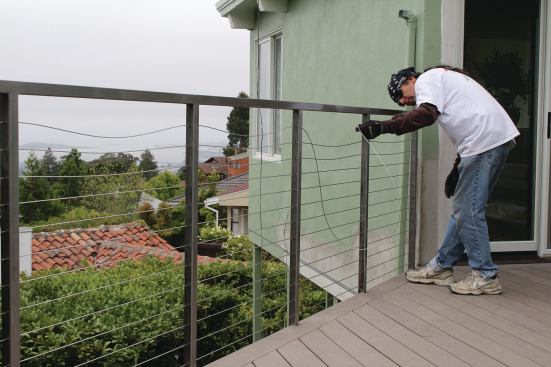

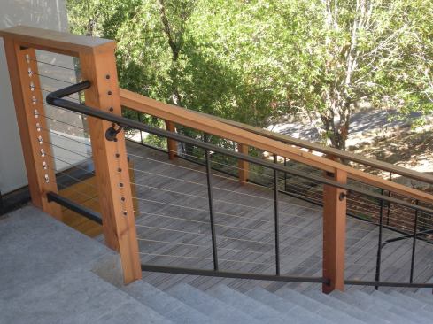

Many installation guides recommend drilling 1/4-inch-diameter holes for the cable, then lining the holes with protective sleeves. I don’t like the sleeves, though, so I use a 3/16-inch-diameter bit for 1/8-inch-diameter cable. I think it looks much better running the cable through very small holes. It requires a little more care when drilling the holes, since a 3/16-inch-diameter bit is more likely to deflect than a 1/4-inch-diameter bit, so I always use a jig and drill the holes from both sides of the post. I mainly use sleeves when there is a direction change, so that the cable doesn’t gnaw away at the sides of the hole.
On long runs, I run the cable through intermediate posts, which maintains the 3-inch-on-center cable spacing I prefer to use. Typically, the longest distance between my intermediate posts, which can be either wood or metal, is 3 feet.

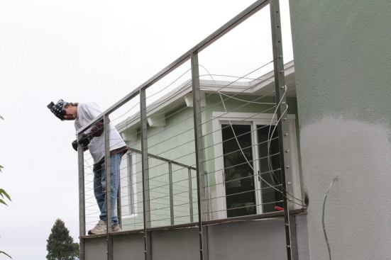

Corners. I never turn a 90-degree corner with a single run of cable and a single wooden post. It’s worth spending the extra money to install two runs of cable, mounted from either a single post or double corner posts (required when the posts are fascia-mounted).

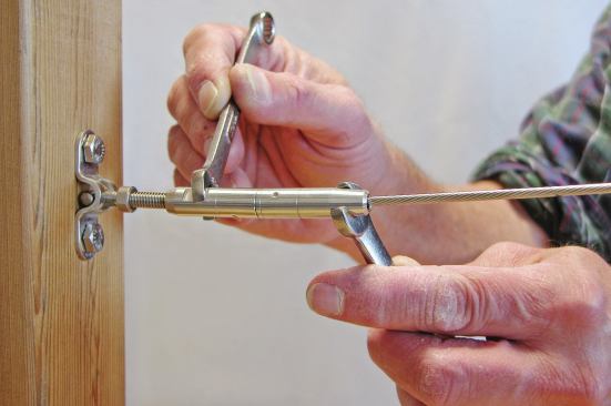

I also try to limit my runs of cable to a maximum of about 60 feet, though I sometimes install longer runs, in which case I also install inline turnbuckles to help tension the cable. Between 240 and 280 foot-pounds of tension will be required on each cable to minimize deflection and ensure that the assembly will meet code (the code requirement is that a 4-inch ball not be able to pass through the cables at the center of the span). That’s a lot: A 36-inch-high guardrail with up to 11 cables will have a total tension of 2,640 lb. on each end post, which must be able to support that load with little or no deflection.
A gauge can be used to accurately measure the tension on each cable, but I just pluck the cables as I tighten them and listen to the sound, as with a guitar, and try to get them all in tune. And as I increase the tension, I sight down the end posts to see if they’re starting to deflect (they always do a little bit). I always go through the tensioning process at least twice.
I sometimes use a cordless drill to tighten the fittings. To avoid seizing the fitting and trashing the entire cable assembly, however, I put the drill on its lowest possible setting and go as slowly as I can. I also make sure I have a helper who can shake the cable and monitor tension while I tighten the cable. I can work solo if tightening the cable by hand.
