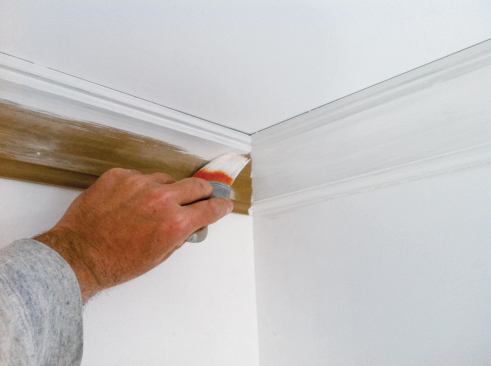

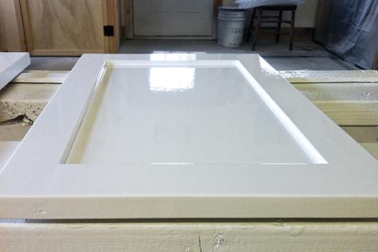

Because waterborne paints dry significantly faster than their oil-based counterparts, it’s harder to keep a wet edge and lay down an even coat. And when wet paint is pulled onto an already-dry surface, unevenness in the sheen of the finish coat — or flashing — can occur.
Complicating matters, waterbornes are much more sensitive than oils to temperature and humidity during application. Keeping a wet edge becomes even trickier when it’s warmer than 77°F or the relative humidity is less than 50 percent (the conditions under which the drying times for most paints are calculated). We much prefer painting on cool and rainy days, when drying times are slower and it’s easier to get a good finish.
Because these differences may be overlooked, waterborne finishes are often incorrectly applied. One of the first things we learned is that you can’t use the same brushing techniques you use with oil. So what do we do when the paint is faster than we are? It’s counterintuitive, but we slow down. These paints are unforgiving and will win if you try to race them. Instead of trying to keep an entire piece wet while working with it, you need to break it down into workable sections.
If we’re painting a door, for example, we paint the panels, then the rails, then the stiles, working the entire piece from the inside out and from top to bottom. To avoid flashing where two elements join, we have to be precise and treat each element as a separate component, since even a small overlap will be noticeable. On the other hand, we can stop painting at a logical break in the sequence, take lunch, and resume painting later without affecting the final finish.
Once laid out and leveled, a waterborne paint quickly dries to the touch as it cures; it won’t sit there in a clammy state collecting dust for 24 hours the way oil paints will. Dust contamination can be a real problem when painting trim and cabinets, where finish quality is critical; using waterborne paints reduces this risk considerably.

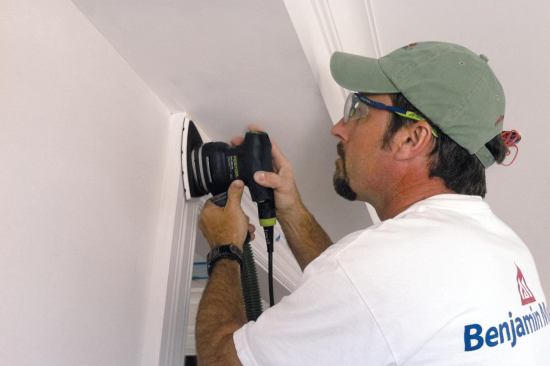

With newly installed carpentry, we start by finish-sanding with 120-grit paper to smooth out joints, ease edges, and remove mill glaze (see Figure 1). We used to spend a lot of time hand-sanding, but this phase of the job is a lot faster and cleaner now that we use Festool gear with dust extraction (888/337-8600, festoolusa.com) for 90 percent of our prep and between-coat sanding.
The Festool finish sander we use most often — the DTS 400 — has a triangular pad that makes it easy to get into corners. We also use Festool’s Granat paper, a fast-cutting aluminum oxide and ceramic hybrid that’s made for sanding painted surfaces and doesn’t load up or leave swirls. For detailed profiles like crowns, coves, and scotia moldings, we use Festool’s LS 130 linear sander, which can be fitted with different sanding-pad profiles. We have a CT 26 vacuum, which is HEPA-rated, so we can also use it on our occasional RRP jobs.

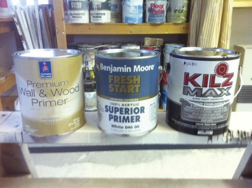

In interior work, the primer’s function is to seal the grain and bond well to the wood substrate (Figure 2, previous page). It also provides a sandable base coat so that the top coat can glide over it with little resistance, which is critical with faster-drying paints. Some manufacturers offer hybrid water-based paint/primers, but we don’t use them because they don’t eliminate the need for multiple top coats on most projects.
To speed up our between-coat cosmetic work and our finish sequence, we generally use fast-drying water-based primers when working with water-based paints (though water-based top coats can also be used over thick-bodied — and slow-drying — alkyd primers). Two of our favorite primer-and-paint combinations for trimwork are Sherwin-Williams Wall & Wood primer top-coated with S-W Cashmere acrylic latex in a medium-luster finish (800/474-3794, sherwin-williams.com), and Benjamin Moore 046 Fresh Start all-purpose primer top-coated with BM’s 314 Waterborne Satin Impervo (866/708-9180, benjaminmoore.com).
Most all-purpose primers don’t block stains well, so if there are knots or stains from tannin or grain bleeding, we seal them up first with three spot-coats of Zinsser BIN shellac-based primer (847/367-7700, rustoleum.com). We apply the BIN with a throwaway chip brush, lightly sand after the third coat, then brush on (or sometimes spray) the primer.
Since water-based primers typically raise the grain of the wood slightly, it’s important to finish-sand after the prime coat has dried. We use 150- to 180-grit paper to remove grain and any visible brush strokes or other imperfections. If we’re sanding by hand, we vacuum and wipe the trim down with a damp cloth; if we’re sanding with our Festool equipment, we can then go straight to paint.
With preprimed material, some spot priming is usually required to feather back any factory primer that was sanded out during prep. We also inspect and correct cosmetic flaws exposed by the prime coat, such as dimpled fastener holes. Then we caulk gaps with DAP Alex Plus (800/543-3840, dap.com), an acrylic latex caulk fortified with just enough silicone to give it flex, so it resists cracking.

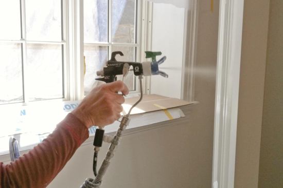

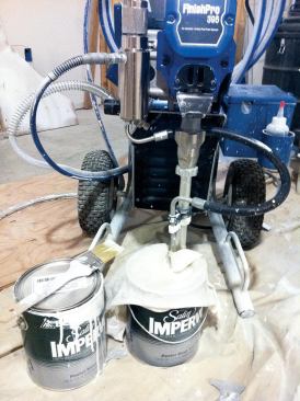

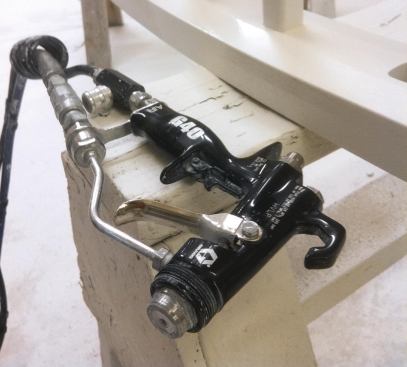

Spraying. High-volume low-pressure (HVLP) rigs are great for oil-based trim finish spraying, but many don’t work as well with the heavier viscosity and temperature sensitivity of water-based paints. Instead, we use air-assisted airless sprayers — either our Graco Finish Pro 395 (800/334-6955, graco.com) or our Titan MultiFinish 440 (800/526-5362, titantool.com). These rigs are essentially traditional airless piston pumps except that they’re also powered by an air compressor and have a separate air hose that mixes air with the paint where it emerges from the tip. With an air-assisted airless sprayer, the fan of paint hits the surface at significantly lower pressures than with conventional airless sprayers, greatly reducing overspray and bounceback. Both our rigs came equipped with high-transfer efficiency HVLP-rated guns, which enhance the performance of these systems (Figure 3, page 52).

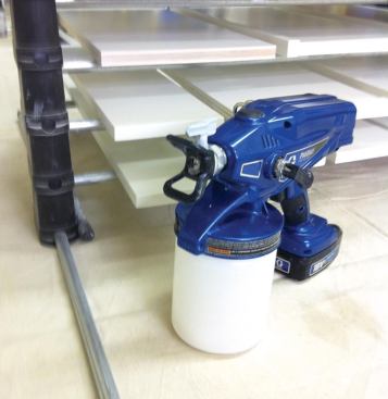

On smaller jobs or when a truly fine HVLP finish is required, we use our Apollo 1050VR HVLP sprayer. This unit has a five-stage turbine for atomizing higher-viscosity coatings like latex. And to spray a few doors or a stack of shelving, we use our Graco 18-volt ProShot cordless sprayer, which lays down a very nice finish and cleans up easily afterward (Figure 4, previous page).

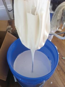

Sprayer manufacturers often recommend additives to reduce wear on sprayer pumps, guns, and tips. Penetrol is the preferred lubricant for oil paints, but for waterbornes (which are more abrasive) we use Floetrol or XIM Latex X-Tender (800/262-8469, ximbonder.com). Before application, we strain our “slicked-up” mixture through a net (Figure 5, previous page). We also set aside a pour-off can where trim paint batches go at the end of the day; when the can gets full, we strain the paint again and use it as a main batch.
One of the tricks when spraying waterbornes is not to get greedy and spray too much at once. We use a “tack coat” approach, where we keep building thin layers with multiple passes of the gun. This results in the best adhesion, and if done in workable sequences where no layer dries before the next is added, all the layers lay down together as a single even coat.
Rolling. When spraying is impractical, we often roll larger surfaces (such as cabinet or entry-door panels) using foam or short-nap velour rollers. Rolled waterbornes can be backbrushed, but it’s not necessary. Backbrushing changes the texture of the finish, so we either roll and backbrush or roll only, but never both.
