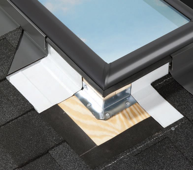

Foolproof Skylight
Velux has redesigned its entire lineup of deck-mounted products and now promotes the collection as the No Leak Skylight. The company is so confident of its leak-free claims it offers a 10-year warranty – not just on the products but on installation, too. No Leak skylights provide three layers of protection against moisture intrusion: a pre-attached gasket that seals the gap between the bottom of the unit and the roof deck; an adhesive underlayment that circles the base of the frame; and a pre-engineered flashing package that features one-piece sill and saddle parts to completely seal the corners. Velux also claims that pre-installed mounting brackets and easily removable counter flashing make these skylights easier to install than their predecessors. A 21-inch-by-46-inch fixed skylight (model FS C06) costs about $230. A manually vented model of the same size (model VS C06) goes for $440. A flashing kit (adhesive underlayment included) costs about $80.
Velux America, 800/888-3589, velux.com.
