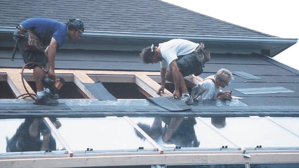

In preparation for the skylight installation, the roof is sheathed and covered with an underlayment. I hold the underlayment back from the openings about 6 to 8 inches, so a waterproof peel-and-stick underlayment can adhere to the roof deck. Up to this point, I’ve temporarily covered the openings with plywood to keep rain out of the room. Before bringing the skylights out onto the roof, I shingle up close to the openings. On hot days, I’ll stop shingling a little lower on the roof so the shingles don’t get scuffed while the skylights are being installed.

When we have all the skylights secured in their final position, I remove the cleat that helped with placement and we cut 10-inch-wide strips of self-adhering eaves membrane for a secondary water barrier. This is the last defense against water infiltration, and the manufacturer requires it. We generally use Grace Ice and Water Shield because it’s readily available and it sticks better than other products I’ve tried.
We start at the bottom, attaching the membrane to the skylight and smoothing it onto the roof. The sides are next, with the areas between adjacent skylights the biggest challenge. With all hands on deck, we take positions at top, bottom, and middle and try to keep the membrane from sticking to itself and making a mess. The piece is cut so that it extends about 6 inches beyond the skylight, top and bottom. We adhere the membrane to one skylight and smooth it down toward the roof and back up onto the other skylight .
Finally, we install the top piece of membrane. It laps over the side pieces and is stuck to the roof sheathing under the felt. We use a hammer stapler to better secure the membrane to the skylight, stapling as close to the membrane’s top edge as possible. This isn’t as critical in warm temperatures, but I had one occasion where the membrane separated from the skylight and had to be redone. Since then, I always staple the membrane as extra insurance.
