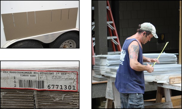

On this project, the homeowner chose HardieShingle straight edge panels with a 7-inch exposure. The 48‑inch-wide by 15 1/4-inch-high panel comes with a factory-painted “ColorPlus” finish on one side, which has a 15-year warranty. The shingles arrive on site bundled together in pairs (two mirror-image patterns are placed with the painted sides facing each other; a plastic protection sheet is inserted between the two to protect the factory paint). The individual shingle tab widths of the mirrored patterns vary slightly, which helps create a look of randomness of the shingles.
HardieShingle straight edge HZ5 panels formulated for extreme weather were installed (left, top). The shingles come bundled in mirror-image pairs, with the painted sides facing each other and separated by a plastic protection sheet (left, bottom; right).

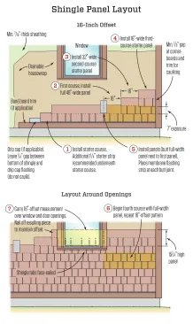

There are two basic rules of thumb for installing panelized shingles: Maintain your installation level line around the home and don’t depart from the manufacturer’s required 16-inch shingle offset pattern. Layout-wise, you install the panels on a façade as if the window and door openings are not there (see illustration below).
Click to enlarge
Maintaining the manufacturer’s recommended 16-inch offset pattern is critical (illustration, above). Drawing based on technical guidelines from HardieShingle-HZ5-Installation Manual.

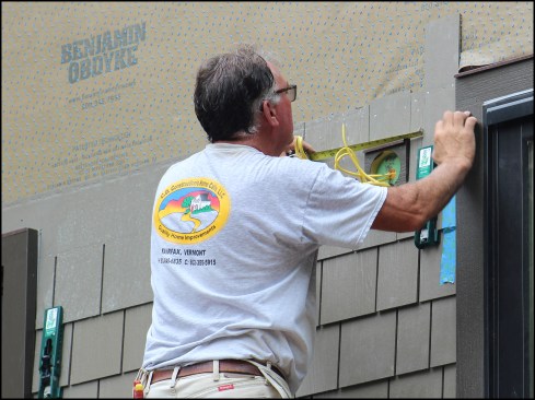

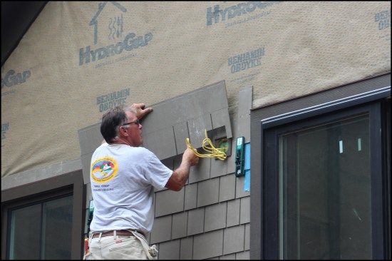

Starting on the garage wall’s façade, we worked clockwise around the house, using chalk lines, a 4-foot level, tape measures, and Gecko Siding Gauges to install the fiber-cement panels. The general contractor had installed all the home’s exterior Boral trim over a drainable WRB, which in turn was installed over 7/16‑inch Zip System wall sheathing (Hardie’s minimum allowable nailing surface for shingle panel fastening).
After the general contractor installed the Boral trim, the shingle panels were applied starting on garage wall façade (opposite façade on the right). The installers clad the house clockwise, lining up the coursing around corners and eventually finishing up back at the garage façade.

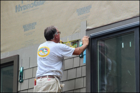

A critical part of a good-looking installation is lining up the shingle coursing from one façade to the next, even when corner boards are installed. We snapped installation level lines, which we transferred over the Boral trimmed-out inside and outside corners, to maintain the alignment. You can tweak the shingle exposure somewhat—1/8 inch here, 1/8 inch there—or make up a 1/2‑inch difference in height over three or four courses between windows, but it’s important to maintain your installation level line around the home in order to line up with the starting façade’s coursing at the end (in this case, on the garage wall).

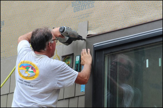

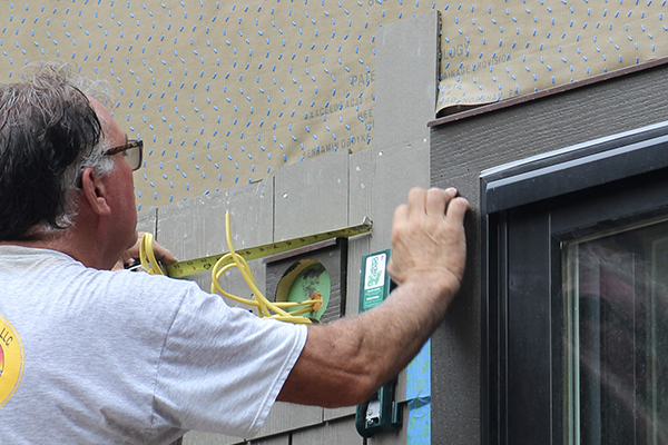

Co-author Carl Dudley measures from the butt end of the shingle and…

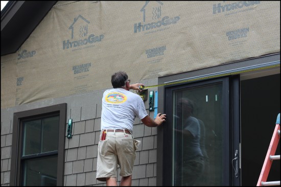

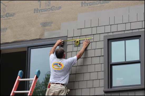

…carries the 48-inch-based panel pattern over the slider door…
…the remaining piece maintains the 16-inch offset. For fastening, a siding nailer with stainless steel ring-shank nails is used to secure the fiber-cement panels; narrow pieces, 4 inches or less, need to be pre-drilled and nailed off by hand.
The next panel is installed around a build-out block needed for a light fixture.
Here, the shingle panel is dry-fit around the fixture block. A circular saw fitted with a fiber-cement saw blade is used to make cut-outs, while a carpenters knife is used to remove material from inside corners as needed. Cut edges are painted with touch-up paint supplied by the manufacturer.

Cutting and fastening. Next, we began installing the shingles per the 16-inch offset pattern, fastening the shingles with approved stainless steel 1 1/2-inch-long ring-shank nails driven from Makita siding nailers; we installed eight nails into a full-width panel. While wearing OSHA-approved half-mask respirators, we cut the fiber-cement siding with sliding compound miter and circular saws fitted with fiber-cement saw blades (see “Cutting Fiber-Cement Siding” for more information on cutting and safety). We painted all the field-cut edges using touch-up paint supplied by the manufacturer.

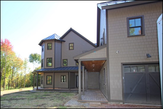

The large home, with its complex geometry, took two experienced installers two months to complete.

Pros and cons. The finished siding looked nice and should last the homeowners a long time, provided they regularly maintain the sealant joints every four to five years. But it was expensive. We installed 50 squares at roughly $550 to $600 per square (pricing may have increased since job completion). And, it’s a time-consuming product to apply; it took two installers two months to side the home.
