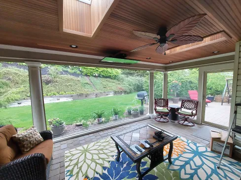

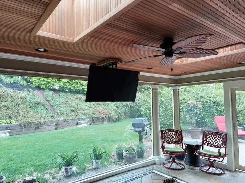

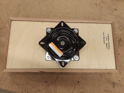

Our go-to method is to mount the TV to a ceiling with a motorized flip-down mount, such as Vivo’s Vesa E-FD55 (less than $200 on Amazon). On flat ceilings, we often add a swivel base so that the viewing angle can be adjusted. We make the base out of scrap LVL clad to match the ceiling finish, and we mount it to an outdoor ball-bearing boat-seat swivel. This assembly blends in well with the ceiling. If the location is windy, we can add a stop pin to lock the swivel in place (see slideshow, below).
Another option is to mount the TV to a power drop-down actuator, operated by remote control, that retracts the TV completely into the ceiling or a wall enclosure. A lid can be fitted to the bottom of the TV hoist so that it closes off when the unit is retracted, but the lid needs to be sized precisely with about a 1/8-inch gap around the margin to fit into the opening. The drop-down mechanism we use has a bounce sensor (very important); when the wind picks up, the mechanism automatically retracts into the ceiling to protect the TV (and itself) from damage.

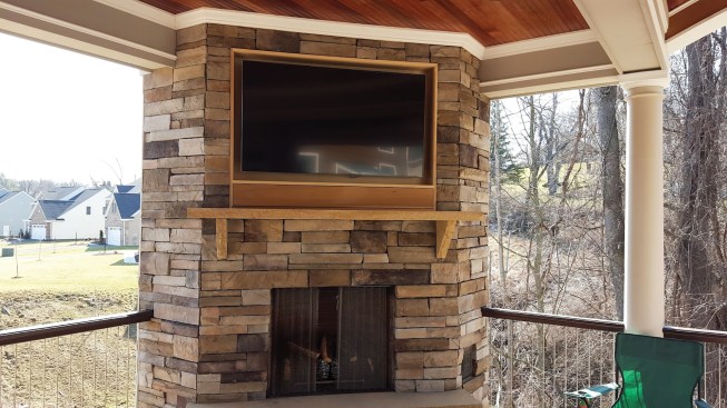

Fireplace mount. Another common place to mount a TV is above an outdoor fireplace, which is usually well-protected from weather and located where it can be seen on a deck or patio. But heat from the fireplace needs to be taken into account, especially if the unit has a gas flame. Usually, these units don’t have a flue, so all the heat comes out the front and can melt the TV. In fact, we won’t install a TV above any fireplace that doesn’t have a mantel to divert the heat, preferably one made of stone that projects at least 10 inches out from the face of the fireplace (see slideshow, below).
An important thing to keep in mind with a fireplace mount—especially if there is a mantel—is the height of the TV. If the TV is too high, it will be uncomfortable to watch, especially when the deck or patio is small. Our recommendation is to make sure the top of the mantel is no higher than 5 feet above the deck and keep the TV as close as possible to the mantel.

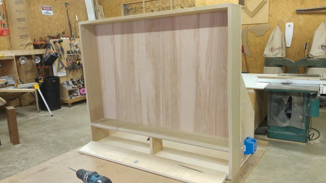

We build these boxes with poplar sides and 3/4-inch birch-plywood fronts and backs, sealing the wood with a coat of polyurethane varnish or a primer/sealer on the back to help keep the wood stable. I use a hidden magnetic push latch for the door so that hardware isn’t visible. Inside the compartment is where outlets for A/C power and data/cable are mounted.
In our TV boxes, we include a door at the bottom that allows wires to be dropped into the wall behind the TV. Boxes can also be used to house DVD players and other audio equipment, remotes for the TV, lights, fans, other accessories, and soundbars; be sure to consult with your customers about their specific plans when you’re designing the box, since these devices will change its dimensions. We also recommend that the box be painted black, just like the TV that it surrounds, to keep the focus on the screen.

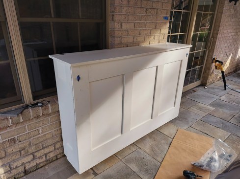

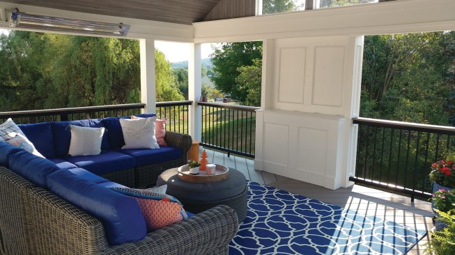

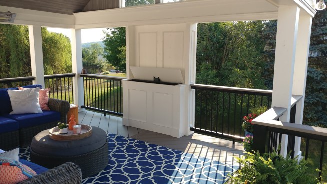

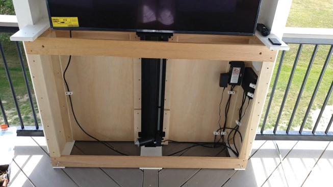

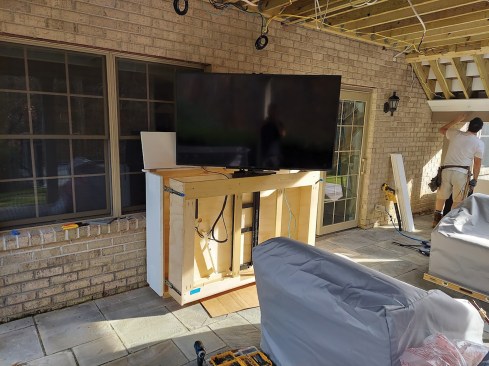

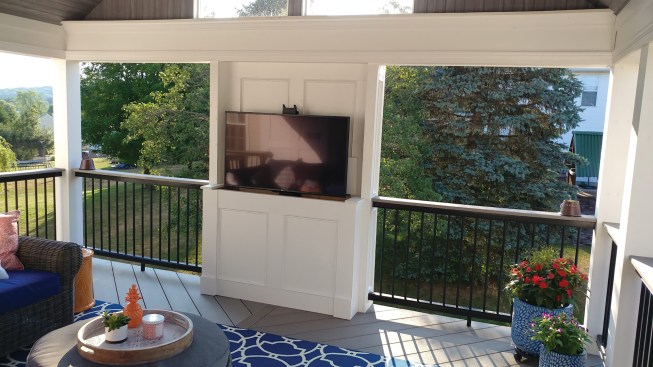

TVs can also be mounted in a cabinet, either a stand-alone unit from a third-party supplier [like Cabinet Tronix] or a custom-made built-in unit. We prefer built-ins, and to make them more dramatic, we like to equip them with power pop-up actuators (see slideshow, below).

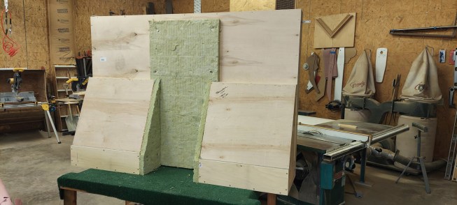

We build our cabinets using 3/4-inch birch plywood for the back and sides, where the mechanicals get mounted, and 1-by poplar for the face frames. Then we clad the cabinet box with PVC panels and top it with a PVC hinged flip lid that conceals the TV when it drops down into the cabinet. When the pop-up actuator moves the TV upward, it pushes the lid open. The lid needs to stay leaning against the lift shaft so that when the shaft retracts, the lid will close by itself when the TV is lowered into the cabinet.
Our cabinets aren’t waterproof, but they stay stable because we install them where they aren’t continually exposed to weather. Keeping in mind that anything mechanical will at one time or another need to be serviced or replaced, we make the front PVC cladding easy to remove to provide access to the equipment. With this PVC cover removed, we make it a point to inspect the actuator movement and make sure the wiring can flex without binding or snagging as the TV raises and lowers. We don’t want the TV to unplug itself.

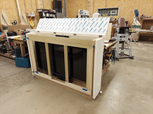

There are two types of pop-up actuators; one holds the TV in a fixed position, while the other can rotate when at the top of lift. When installing a rotating pop-up actuator, we plan for space behind the unit to allow the TV to swing. In tight situations where customers also want rotation, we have built units with a pull-out drawer. If you do that, make sure you get the heaviest stainless-steel ball-bearing slides you can buy. I’ve found that online marine suppliers are a good source for hardware used in outdoor applications. With a swivel-type TV mount, the rotating TV will push the lid over to lay flat, so keep in mind that the lid will have to be manually flipped back to the closed position when the TV retracts.

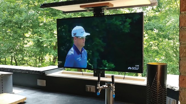

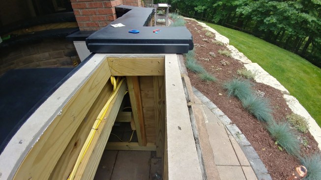

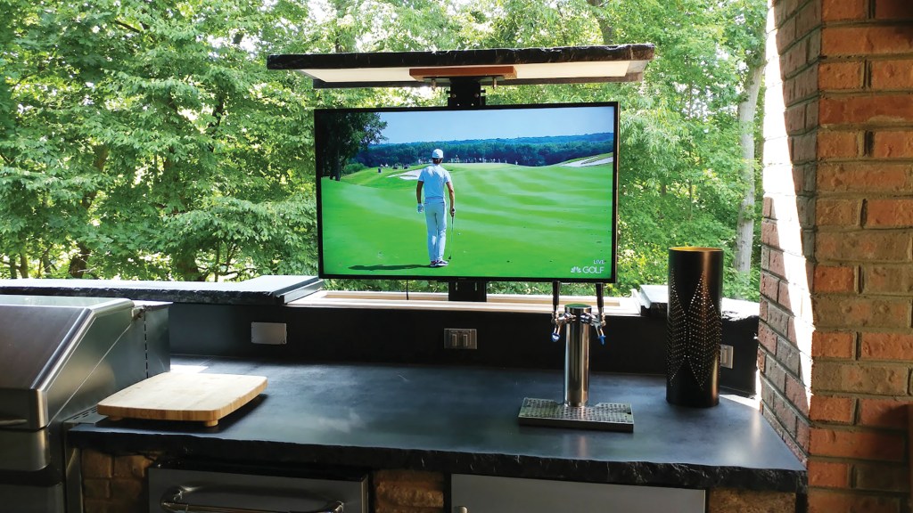

A creative yet challenging version of the pop-up style that we built was in the backsplash area of an outdoor bar. The countertop was made using custom concrete, the lid had to lift and retract with the TV, and the assembly had to be waterproof since it was located near the edge of the covered area.
To prevent water from getting inside the box, we added a gutter system on each side so that the lid would overlap the gutter and any water reaching the edge would channel out and away. The other thing I was concerned about was that the mechanism would eventually wear to the point that it wouldn’t seat the lid exactly every time, or that outdoor dampness would affect the movement and cause damage to the concrete top. Our solution was to spring-load the cap to the mechanism so that when the top seated, it would rely on the springs to constantly adjust as needed (see below).
To install a pop-up style of TV lift in an outdoor bar, the author devised a simple gutter (shown here at one end  where the concrete counter ends at the opening for the TV and pop-up assembly) to channel water away from the assembly.
When the TV is retracted, the lid covers the recess where the TV is stored, and any water entering at the ends is channeled away by the two short gutters at each end. The lid lifts up and out of the way when the mechanism raises the TV into viewing position, as shown above.
When the TV is retracted, the lid covers the recess where the TV is stored, and two short gutters at each end channel away any water that enters. The lid lifts up and out of the way when the mechanism raises the TV into viewing position, as shown above.
