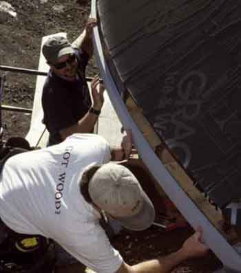

As with the framing, we spent some extra time laying out soffit bays so that they’d all be exactly the same size. We marked the inside curve on the first soffit board by holding it in place and scribing it with a compass. We worked our way out toward the fascia, blind nailing through the tongue with a trim nailer. Running the soffit 3/8 inch past the rafter tail allowed us to slip it into a dado on the back of the curved fascia. At the last course, we used a 3/8-inch-thick piece of stock held against the plumb cut on the rafter tails to scribe a fair curve.
Templating
The next step was to make 1/4-inch-thick plywood templates of the curved fascia and the curving frieze board that would circle the top of the tower below the soffit. Using the soffits, we scribed the 8-foot sheets in place and then sent them to the millwork shop that supplied the trim, Tidewater Millwork of Woolwich, Maine.
Tidewater determined the radius from our original templates and, using 1/4-inch laminations of mahogany, made the fascia and frieze boards to match. The radius of the decorative crown applied to the fascia was determined by adding its thickness to our original templates. For the frieze and other components with a smaller radius than the fascia, we subtracted the width of the overhang from the original template.
