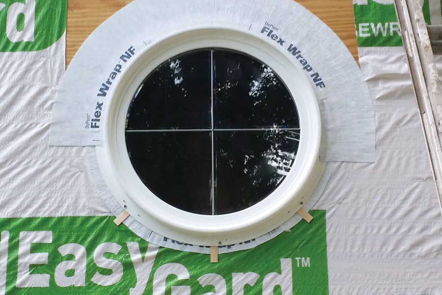

A flexible butyl-based flashing material works well for flashing roundtop windows, but the sill is tricky. In this case, the installer has left the bottom uncaulked and added shims to promote drainage.

Mike Schuler (email, 1/10/16): I have a job requiring installation of small (24-inch diameter) flanged circular windows. We have installed several already, using Dupont Flex-Wrap both at the head and in forming the equivalent of a sill pan for the lower half of the circular assembly.
First, we cut circular holes through the sheathing. We then blocked-in the framing for the bottom half of the window to form a round sill to match the shape of the opening. We angled the cut at the bottom so any water would drain to the outside. We then installed the window, applying sealant to the back of the top half of the flange. We slipped thin (1/16-inch) shims under the screws at the bottom, again to provide a way for water to escape. We followed with FlexWrap applied over the top half of the flange and stuck (mostly) directly to the sheathing (see photo, left). Next time, we will cut back the moisture barrier farther at the sides so every bit of the FlexWrap is adhered directly to sheathing.) As a final step, we lapped and taped the moisture barrier over the FlexWrap.
What we did seemed logical to us, but it was a first attempt at this detail. Do you have recommendations for such installations similar to the one published in JLC for rectangular windows?
Harrison McCampbell responds: The details you propose sound right if I am understanding your approach correctly. In addition to the weather barrier and flashing details, an important detail you provided is to continuously caulk the top half of the circle, applying the caulk as the window gets installed. I would extend the caulk a little below the top half, but leave the bottom open. The shims at the bottom should help promote positive drainage of any water that leaks through the window unit, but I would still be inclined to create a raised edge along the inside of the sill (maybe 6 inches wide and 1/2 inch high in the center at the bottom of the window, which is the only place where this will matter on a circle window). This raised edge could be hidden with trim but would effectively act as a dam to prevent water that gets past the window from leaking inside.
