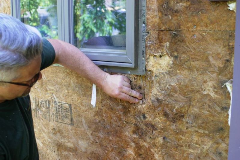

Our routine examination of a house includes a visual inspection, a blower-door test, and an infrared camera scan to identify heat-flow issues. In the case of this house, the visual inspection showed damage to the foam perimeter insulation around the basement foundation, caused by ants who made their home in the insulation, and by woodpeckers who were hunting the ants.

In themselves, the air leaks would not have been difficult to address. But the infrared scan of the walls also revealed another kind of serious trouble: major settling of the insulation, which we could see on the infrared images from the outside of the house as red heat blooms in the walls, and from the inside as blue cold areas.
My report to the homeowners read, “All exterior walls were found to have significant settling of the cellulose insulation. We suspect that the cellulose, when installed in the 1980s, was not installed under pressure (dense-pack) as is the current practice. Some walls have seen as much as a 40% reduction in the insulation coverage through settling. There were also areas, notably the front wall of the master bedroom, where rodent pathways were visible on the infrared camera image. Upon direct inspection, the air in the double stud wall cavity in the gable end of the living room was found to have a relative humidity 10% higher than the ambient humidity in the room (64%). This high humidity in the wall cavity near the insulation indicates that the insulation itself is damp, which is a possible invitation to the carpenter ants that have plagued the structure.”
The dampness inside the wall was the result of a double vapor-barrier assembly, consisting of a poly liner behind the drywall on the interior wall, plus oriented strand board (OSB) sheathing with a standard housewrap on the exterior. While OSB may be structurally equivalent to plywood in the building code, the two types of structural panel don’t have the same moisture transmission characteristics—OSB is less vapor permeable. Depending on the adhesives and the conditions of manufacture, OSB can have a perm rating low enough to be considered a vapor barrier (sometimes as low as 0.1 perms). In this case, it appeared that the assembly amounted to a vapor “sandwich”—common practice that is still being replicated today throughout the country.

In order to protect the existing walls against the weather as we worked, I decided to demo and rebuild the house one wall at a time, sheltering each exposed wall with tarps until we had made the assembly rain-resistant again. As we stripped off the siding and sheathing, we uncovered damp, settled insulation, confirming the evidence of our infrared photos. We were also able to inspect the sheathing and framing directly, and we found that the sheathing was deteriorating from dampness and decay (you could easily pull the OSB apart with your fingers). Most of the wall framing was still sound, but the floor framing was not; we discovered that we would need to remove and replace portions of the first-floor band joist where the wood was rotted and infested with ants.
After opening up the walls, we vacuumed out the moisture-damaged and settled cellulose insulation, along with its load of animal droppings, urine, hair, insects, and mildew. That contaminated material and its load of allergens got pumped into disposal bags inside the dumpster.
Interestingly, as we exposed the back side of the drywall on the inner wall frame, we could see how the original builder had carefully air-sealed wiring penetrations and electrical boxes. The home’s builders were evidently well-intentioned and had made a serious effort to do a good job—but they were working without a full understanding of the building science involved or of the properties of the materials they employed.
We also removed the poly vapor barrier from the back side of the drywall. The plastic on the inside of the house had caused more problems than it solved, as is commonly the case. Later we would achieve the poly’s vapor-control objective using a more advanced material that was more carefully detailed and placed in a more appropriate location within the cross-section of the wall.
