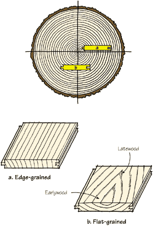

Excessive dimensional change constantly stresses a film-forming finish, such as paint or a solid-color stain, and may result in early failure. Finishes that don’t form a film, such as penetrating stains, are not affected by these dimensional changes. Flat-grain vs. edge-grain. Softwood lumber is referred to as either flat-grained or edge-grained (plainsawn or quartersawn in hardwoods). Most standard lumber grades contain a high percentage of flat grain. Flat-grained lumber shrinks and swells more than edge-grained lumber (see Figure 1), so edge-grained lumber will usually hold paint better than flat-grained material.
Flat-grained lumber shrinks and swells more than edge-grained (quartersawn) lumber and also has wider bands of dark latewood. Therefore, edge-grained siding will usually hold paint better than flat-grained material.
Some bevel sidings are produced in both a flat-grained standard grade and an edge-grained premium grade (sometimes called vertical grain).
Earlywood and latewood.
Another reason that edge-grained siding holds paint better is that edge-grained wood has narrower bands of latewood. Earlywood and latewood form in two distinct bands within an annual growth ring. Latewood is denser, harder, smoother, and darker than earlywood. Although new paint or solid-color stain will adhere well to both earlywood and latewood, old alkyd paints and solid-color stains that have become brittle with age and weathering will peel first from the smooth, hard surface of the latewood.
