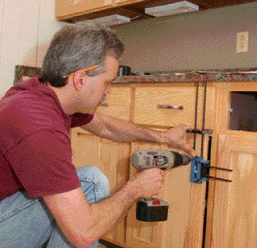

Quite often, I find nothing wrong with the look of the old cabinets other than superficial wear and tear. If it turns out that my customer is actually happy with the original cabinets' style, we'll do a tune-up, cleaning and restoring worn, scratched finishes and servicing or replacing worn or outdated hardware. Often we'll replace the counter as well. The average tune-up cost, not including the counter, is around $650 for a job that's completed in one day.
Wax stripper, wood cleaner, and scratch-filler products prepare worn cabinets for a renewed finish of penetrating oils and color lacquer.
Rob Carter, who handles much of our field service, uses a family of proprietary cleaning and restoration products to remove or disguise scratches and worn areas in the finish and restore the overall gloss. He cleans and adjusts or replaces drawer slides, door hinges, catches, and decorative pulls. When completed, the kitchen has close to its original appearance, with re-aligned and smooth-working drawers and doors. We leave the customer with maintenance tips and bottles of proprietary cleaning and polishing products. Tune-ups generate great word-of-mouth referrals and account for approximately 20 percent of the jobs we do.

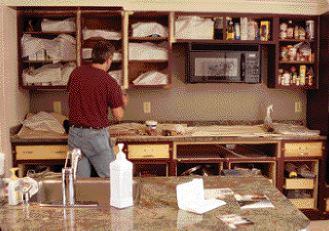

When the cabinet style has worn out its welcome, a tune-up won't suffice. Instead, we replace the doors, drawers, and hardware, and give the kitchen an entirely new look. The first task is to accurately measure the existing cabinets, taking careful note of face-frame and opening widths and the divisions between cabinets. We ignore existing door and drawer dimensions, but carefully calculate the overlays and reveals between faces to create a new, uniform layout. We then order the new door and drawer fronts accordingly. It's a painstaking and time-consuming process, but it pays big dividends in the final outcome.
What stays, what goes. I'll often suggest minor changes, such as repartitioning a cabinet or replacing particleboard shelves with edge-banded plywood or solid lumber shelving. Solid lumber shelves cost more, so I suggest using them only where they're open or visible. As an option, we can also reline cabinet interiors with prefinished 1/4-inch plywood, glued and tacked in place, but we recommend restricting this treatment to open and glass-front cabinets. Otherwise, the cost can approach that of a new cabinet.
Part of the beauty of both the tune-up and the refacing processes is that the cabinets don't have to be emptied, so they're never taken out of service.
Like any job done well, 80 percent of the work lies in the preparation. Demolition typically involves more than simply removing the cabinet doors and front panels. Existing valences and built-in soffits may no longer have a function in the revised kitchen, so we often remove them. We also often replace the old wall-mounted exhaust fan with a range hood, leaving a hole to repair. Window and door trim may need to be replaced to match the cabinets. A new wall oven may require a slightly different-size cabinet opening, calling for face-frame modifications. Sometimes, we can revise the layout slightly, swapping a sink base for a cooktop or vice versa. This requires the addition or removal of stiles and rails, new interior bracing, and other modifications to the cabinetry. The demolition and restructuring phase typically accounts for two-thirds of the time spent on the job. By the time Rob tackles the actual refacing, he's in the home stretch.
