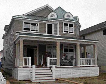

Ocean City sits on a barrier island that ranges from two to seven blocks wide. With the Atlantic to the east and a narrow bay to the west, explains Smokey Saduk of Haffelfinger and Standeven Construction, homes are continually exposed to a salt wind that eats paint alive. “Some of the houses here cost $20,000 to paint,” he says, “and they’re painting them every couple of years.”
But even worse than salt spray is “sand pack” — wind-driven microscopic sand particles that sift into every crack and crevice. Over five or six years, notes Smokey, the fine sand accumulates in joints, where it holds moisture through capillary attraction and begins to rot sheathing, wood siding, and wood trim from the inside out. “I have pulled stuff apart in remodeling work,” he explains, “and found the back side of cedar trim and siding rotted out all around the windows, just punked out where it was plastered against the wall.”
That won’t fly in this coastal market. With an average sale price between $1.5 and $2.2 million per floor for duplexes, Smokey thinks customers come to expect something more. In Haffelfinger and Standeven homes, that “more” comes with attention to interior and exterior details. But in a coastal environment, it’s the exterior details that have undergone the biggest changes.

Haffelfinger and Standeven homes typically stand on tight lots in the mostly built-out existing neighborhoods of Ocean City. Homes often hug the lot lines, with only a few feet separating neighbors. Many of the houses are simple squares or rectangles to maximize lot coverage, but you wouldn’t necessarily pick this out from the street. The company makes the most of each building’s front exposure, incorporating polygon bump-outs, barrel vault dormers, carefully trimmed-out arches, and eyebrow windows (Figure 1), as well as decorative porch details (Figure 2). Eaves and cornices get layered trim treatments using profiled Azek, as do windows, doors, and porch beams (Figure 3).

Although there’s not a single stick of wood showing, the finished homes hark back to the intricate woodwork of the Victorian or Georgian periods. “I picked up a lot of ideas from Colonial Williamsburg,” says Smokey. “And I’m only half an hour north of Cape May [a New Jersey seaside resort noted for its Victorian architecture], so I am always down there picking up ideas.”
Initially, Saduk’s attention was focused on reproducing traditional details in cedar. But in the last five or six years, he’s made the switch to all synthetic materials (see “A Palette of Plastics,” below): Azek cellular PVC board and sheet stock, Fypon coated-polyurethane decorative elements, and Permacast marble-and-resin synthetic columns. The Azek is never painted; the Fypon (which comes with a primer coat) and Permacast are painted on site.
Impervious package. Made of impervious materials and installed with tight, carefully worked joints (and even, in places, with adhesive-welded bonds), Saduk’s siding and trim package sheds the majority of water that strikes the building in the rainy shore climate. “We use no surface caulk on the building, because the beach sand sticks to it and makes a black outline,” explains Smokey. The building relies instead on water-management details buried beneath the siding and trim; this secondary weather barrier is carefully applied and flashed before any of the siding or finish materials are installed.
