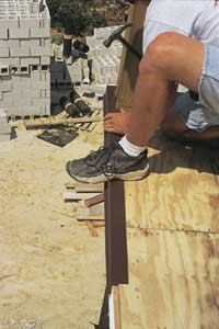

Edge Treatment
At the perimeter of the deck, we ease the corner of the face board with a router and a 1/4-inch round-over bit. When the router won’t fit and bumps up against a post, we ease the edge with a sander. There are two ways to treat the edge. If the carpenters have not left a clean, tight joint between the plywood and the face board, we cap the corner with a custom-bent metal drip-edge (Figure 3). We try to avoid this detail, however, because the metal can telegraph through the surface of the Duradek. We prefer to have the sheathing meet the face board perfectly, in which case we use a flat metal strip with a kickout bend along the bottom edge. This is applied vertically to the face board with the top edge aligned just below the rounded-over corner. The metal still telegraphs through, but it’s out of the line of sight.
Figure 3. At the perimeter, the membrane is glued over a custom-bent metal drip-edge (left). To create a finished edge, the membrane is tucked under the kickout and capped with a vinyl trim strip (above
Whichever flashing method we use, the Duradek membrane is glued over the metal and tucked under the kickout. A continuous vinyl trim piece holds it in place and makes for a clean finished edge.
