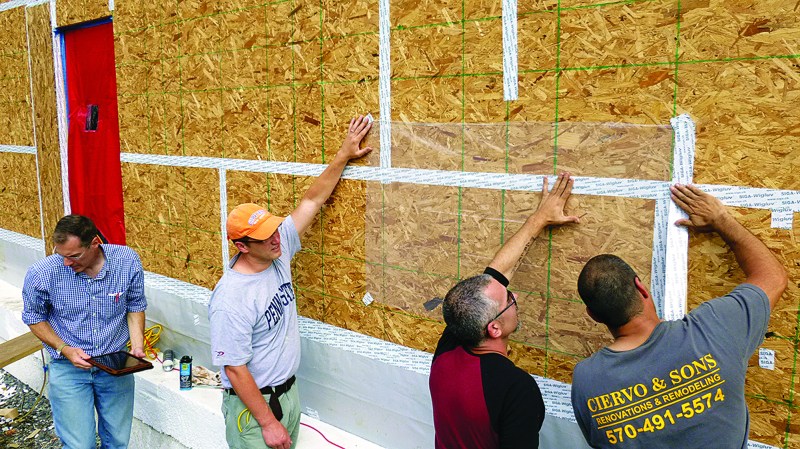

One popular approach among the Passive House crowd is to rely on OSB sheathing, taped at the seams, as the air barrier (or “air control layer”) for the house. That’s the method architect Richard Pedranti chose for his first Passive House, in 2014 in Scranton, Pa. But to his dismay, Pedranti’s house failed its first blower-door test. The reason? Under 50 pascals of pressure, the OSB leaked air—not at the taped seams, but all across the faces of the panels.
Pedranti’s wall assembly was a 2×4 frame with taped OSB sheathing and wood I-joists applied over the outside face of the wall to create a 12-inch cavity for dense-blown cellulose insulation. The outside face of the I-joist wall was to be sheathed with vapor-open particleboard, then double-strapped for siding—essentially, the same wall system described in by Maine Passive House builder Chris Corson (“An Affordable Passive House,” May/12 and Jun/12).
“We never questioned using OSB as our vapor and airtight layer,” Pedranti told “The industry accepted it.” But with walls and roof framed and sheathed (but no I-joist layer yet), the building tested at 1.5 ACH50. “We spent hours and hours chasing leaks,” said Pedranti, “but at the end of the day we were still at 1.1 ACH50.” Then Pedranti’s HERS rater, Pete Vargo, suggested reversing the blower-door fan, pressurizing the building, and taking a look at the outside. When the crew taped plastic over the OSB walls, Vargo’s suspicions were confirmed: Air was leaking through the OSB.

Also, Pedranti noted, he had already air-sealed the OSB joints with Siga Wigluv tape, which has a water-based adhesive. Solvents in the fluid membranes might attack the tape. So Pedranti decided to apply another Siga product to his building: Siga Majpell air-barrier fabric, sealed at the joints with Siga Majvest double-sided tape.
The fix cost more than $3,000, said Pedranti (“the tape is good, but it’s expensive,” he said). But it took just a few hours—and with a layer of Majpell over the OSB, the house was tighter than 0.3 ACH50.

Since Maine builder Chris Corson helped Pedranti solve his Pennsylvania problem, Corson has had his own encounter with leaky OSB—in Corson’s case, for a Passive House in Camden, Maine. Corson has built dozens of Passive Houses since 2012, panelizing his 2×4 stud and I-joist walls in a warehouse near Belfast, Maine. Corson has been comfortable with an OSB air barrier despite Pedranti’s experience, and despite research showing wide variation in OSB air permeability. And until recently, Corson’s field experience confirmed his confidence, with house after house handily beating Passive House criteria.
But in December, Corson’s crew had the same experience Pedranti described. “We tested the house and got like 0.7 ACH50,” Corson told . “I said, ‘What’s going on?’ And after running around chasing leaks all day, I said, ‘Let’s look at the OSB.’ We taped plastic over the wall and cranked the blower door up to 150 pascals, and sure enough, the air was coming right through the OSB.”
Corson’s solution was to coat the inside face of the OSB sheathing between the wall studs with a fluid-applied Prosoco flashing membrane (the outside face of the OSB was already buried under I-joists and cellulose). After that, he told the house tested out at 0.28 ACH50. And like Pedranti, Corson made the decision to switch to using Zip System sheathing for his air barrier. “For [an extra] $600, it solves the problem,” he said. “It’s a no-brainer.”
