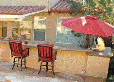

Coastal designers report that outdoor kitchens are a hit with residents. Marieanne Khoury-Vogt, town architect for Alys Beach, a sustainable, Gulf-front community in the Florida Panhandle, has designed an outdoor kitchen for the second-floor terrace of one of its compounds as an amenity for residents. “It’s been used a tremendous amount,” Khoury-Vogt says. “Having the ability to cook and dine outside is a wonderful part of vacation living.”
Built against a 42-inch-high wall, the kitchen features a stainless steel stove, a sink that’s deep enough to handle large platters, an ice maker, a dishwasher built into a masonry enclosure, and ample counter and storage space. A 1-inch-thick shellstone countertop coordinates with the shellstone pavers on the floor.
With some advance planning, construction was fairly simple, Khoury-Vogt reports. When the house was built, the terrace was stubbed for water and gas
and wired for lights and outdoor speakers. “All construction had to do was build the frame. The appliances went in and that was it,” she says. “We mounted a couple of vapor lights on top of the wall.”
