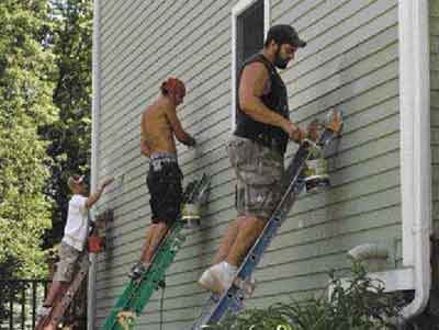

Three painters work together on the shady side of a house to get the paint on quickly. Modern acrylic paints and stains tend to dry quickly compared with older, higher-VOC formulas.

What does all this mean for the professional painter? Most agree that modern paints perform as well as, or better than, traditional coatings: they stick better, last longer, and hold color better. But the new paints tend to behave differently on the brush or in the sprayer. For many painters, adjusting can be a challenge.
Nigel Costolloe runs Catchlight Inc., a custom painting company in the Boston, Mass., area. Says Costolloe, “Years of habit and practice and skills, honed in the application of one type of material, when confronted with a material that behaves markedly differently, is a challenge for anyone.” If a painter is accustomed to brushing or spraying oil formulas, he’ll find modern acrylics tricky at first. Oil paints dry slowly and provide lots of “open time” for painters to brush back into their work, and oil paints relax gently, allowing brush marks or lap marks to disappear more readily. Modern acrylic paints dry much faster — especially if the weather is hot, dry, or breezy — and so lap or brush marks are harder to avoid.
To keep a house looking good, walls need to be routinely washed and repainted every few years. In coastal zones, three years between recoats is fairly good performance for paint or stain over wood siding and trim.
New England painter Charles Gilley has modified his technique to accommodate the faster-drying new acrylics. On a building exterior, for example, he has to paint fewer courses of clapboards at a time, in order to maintain a wet edge as he works. On sunny days, Gilley has to hustle to stay on the shady side of the building — once a wall is hot and sunny, the paint dries too fast. And for wood-panel doors, Gilley now follows a meticulous pattern, painting first the panels, then the rails, and then finally the stiles, so that cross brushstrokes won’t create visible lap lines across the door’s component parts.
