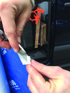

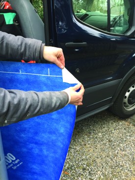

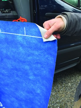

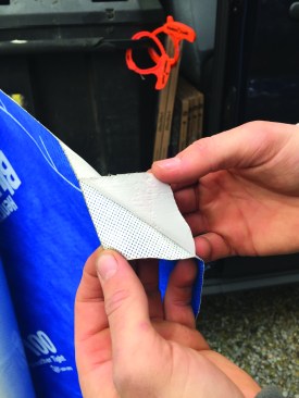

Here’s my tip: Fold the corner of the product over on its face (top left). Using your thumb and forefinger, rake your thumb tip over the corner a few times (top right). That generally stretches and loosens the film enough that you can grab it with your stubby fingers or at least create an opening between the backing and the membrane to get your knife blade behind it (bottom left) and peel it back (bottom right).
