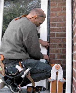

Installing and Flashing the Door
Before installing the door, I wrapped the trimmers with the Vycor Plus (Figure 4). This flashing strip should lap over the upturned edge of the copper pan so that any water that might drip down the flashing will drain into the pan and toward the exterior. It’s important to remember to never reverse-lap, or water can seep into the interior cavity.
FIGURE 4. The author sandwiches the door’s nailing flange in Vycor Plus (both photos) — one layer hugging the trimmers and a second layer lapping the flange. While sometimes considered a redundancy, this “belt and suspenders” approach provides protection from the hard-driving northeasterly winds that blow across Long Island in winter.
To install the door, we removed the sliding panel to make the unit as light as possible. We then lifted the door up onto our scaffolding. The sill was already dead level, so shimming the bottom sill was not necessary. (On large door units, I find it better to reset the sill and get it perfectly level rather than try to shim the door.) I checked that the door was square in the opening by using a diagonal measurement across the unit. We double-checked for plumb and level before installing the sliding panel, then checked to make sure the door operated smoothly.
This door model called for nailing the flange to the sheathing with 11/2-inch roofing nails and side jamb screws. The side jamb screws were not a problem; I first shimmed behind each side jamb screw before setting the factory-supplied screws into the existing trimmer studs, repeatedly checking the door operation as I went. But nailing the flange would have been tough because of the brick veneer. Not willing to risk damage from an errant hammer head, I instructed my helper to screw it in with 2-inch coated deck screws instead of using the roofing nails. Most manufacturers require a bead of caulk on the back of the nailing flange as well. While this barrier by itself is unlikely to keep out water over time, it’s always wise to comply with the manufacturer’s instructions. This will cover you in the event of a problem later.
Next, I installed another strip of Vycor Plus flashing to prevent driving rain from getting into the cavity between the rough framing and the door unit. To make this piece, I stripped smaller widths out of the standard 9-inch width. To facilitate slicing the flashing tape, I use a scrap strip of plywood into which I’ve cut saw kerfs at 3, 4, 5, and 6 inches from one edge. I can then lay the tape over the board and easily run a utility knife down the slot.
It’s a good idea to wipe down the door frame with alcohol to clean the flange before applying the flashing tape. When installing the flashing, I cover about 1/4 inch of the flange — enough to cover the mechanical joint but not so much that it can be seen after the exterior trim is installed.
