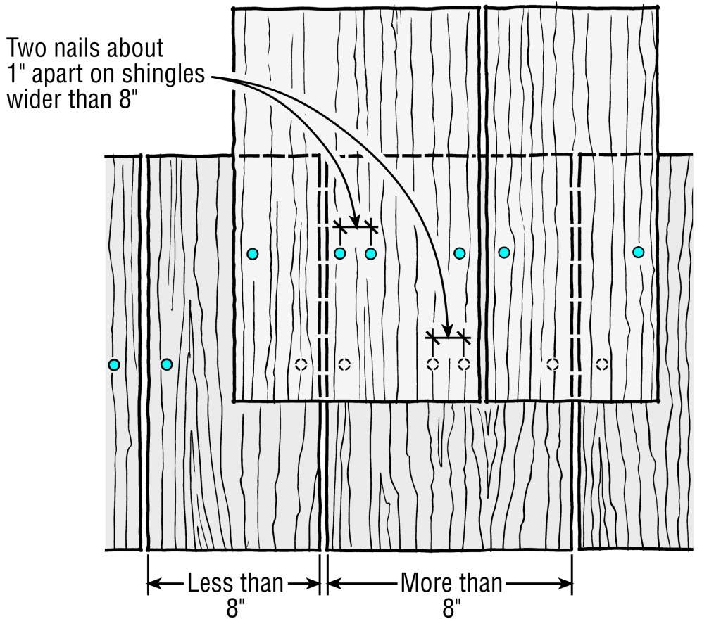

Preventing Splits in Wide Shingles
Wide side-wall shingles (over 8 in.) are prone to splitting. To avoid problems, blind-nail as shown above.
