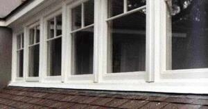

Special Solutions for Windows
The area where jambs and casings meet window sills is a potential trouble spot. In new construction or where it’s possible to trim the casing short, I leave a 1/4-inch to 1/8-inch gap where the casing meets the sill and fill it with Cor-A-Vent or screening. Another option is to drain these joint intersections with 1/4-inch angled weep holes that come out just behind the casing and out the bottom of the sill just past the siding.
In locations with especially severe weather, I also drill a series of 1/4-inch holes in the bottom rail of sash to drain away any water that penetrates behind stops. I epoxy-coat drilled holes with a long cotton or foam swab or with a 1/4-inch flux or artist’s brush, and then cap them with a small thimble vent.
To make a long-lasting caulk joint on long horizontal joints — for example, where a subsill meets a sill — I cut a slot with a special tool called a corner grooving machine that’s designed for installing weather stripping (Resource Conservation Technology, 410/366-1146, www.conservationtechnology.com). Instead of foam backer rod, I use bulb weather stripping from the same company to fill the slot before caulking, which gives the joint flexibility and improves adhesion.
If any repairs to the sash are needed, I use either Abatron’s LiquidWood/WoodEpox system or West System adhesive epoxy, depending on how structural the repair needs to be (West System is stronger, but harder to sand). After making repairs and sanding everything, I apply a coat of West System 105/207 epoxy and a coat of DuPont Corlar 26P epoxy enamel. The 26P is applied when the 105/207 goes into the green stage — that is, when it is tack-free, but not fully hard — which eliminates the need to key sand the fully hardened 105/207 for good adhesion of the subsequent coat. This technique also works when using West 105 with alkyd or latex primers.
