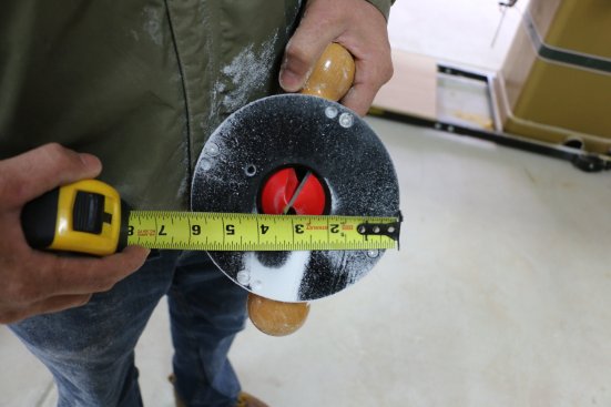

A large V-groove bit is the key to cutting the miter-fold post wraps. To lay out the groves, measure from the center of the bit to the edge of the fence.
Nathaniel Eldon

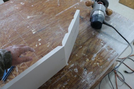

After laying out the grooves, cut a test piece to make sure the grooves are the right depth and that the folds create a perfect square.
Nathaniel Eldon

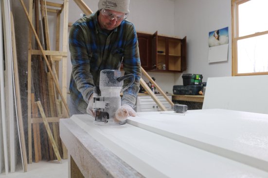

I make the cuts by running a router against a straightedge. To lay out the position for my straightedge, I first took into account the width of my router base. The 2.25 HP Bosch router that I use has a 6-inch base. Then, I simply added half the width of the base, or 3 inches. This put the straightedge layouts at 3 inches, 8 1/8 inches, 13 1/4 inches, 18 3/8 inches, and 23 1/2 inches. I noted these numbers so that I could lay out the rest of the sheets that I’d need to make all six post wraps.

As mentioned above, I make the grooves for the miter folds using a 90-degree V-grooving bit. If you are going to make your own post wraps using a router bit, I recommend getting a large V-grooving bit with a 1/2-inch shank. The heavier shanks are much safer to use, and the cutter is large enough to make miter-folds in material up to 1 inch thick.
Before I start cutting the post wraps, I always check the depth of the router bit using some scrap of the material that I’ll be working with. Setting the depth of the cut exactly right is critical. The objective is to cut almost—but not completely—through the stock, creating a joint that is flexible enough to be folded by hand. I generally leave less than 1/16 inch of material. Held up to the light, the bottom of the groove is translucent. Once I’ve set the depth of the bit, I label and stow away the test scrap with the hope that I’ll be able to find it the next time I have a similar job using that stock thickness.

Routing PVC is dust-intensive, so I always wear protective glasses, and if I’m cutting a large number of sheets, I also don a dust mask—and sometimes even a Tyvek suit to keep my clothes dust-free and my wife happy.
A straightedge is clamped to the layout marks on a sheet of PVC and the router follows one edge. Be sure the rotation of the bit is pushing the router table against the straightedge.
Nathaniel Eldon
Once the router is dialed-in and the first sheet is laid out, I clamp the straightedge on the layout. Router bits always rotate clockwise, so keep the straightedge to the left of the router when cutting. That way, the direction of the rotation pushes the router base against the straightedge and keeps the router from walking away from the straightedge.
As I make a pass with the router, I make sure that dust doesn’t build up between the router base and the straightedge. Any buildup can push the router away from the straightedge, leaving you with a groove and a miter joint that is not straight and true.

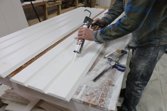

After I’ve cut the grooves, I carefully sweep the dust off the grooved sheets to get them ready for glue. Because we needed to wrap posts that were already in place, the most successful strategy was to install three-sided wraps, leaving the final side loose to be installed later. We sliced the sheets into sections of three sides by running a razor knife down the base of the appropriate groove.
A bead of PVC adhesive is squeezed into the second and third grooves.
Nathaniel Eldon
The post wraps are three sided, so after the grooves are cut, a razor knife slices down one of the grooves to create groups of three sides.
Nathaniel Eldon

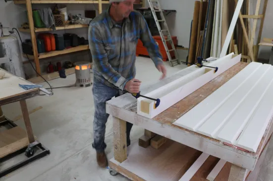

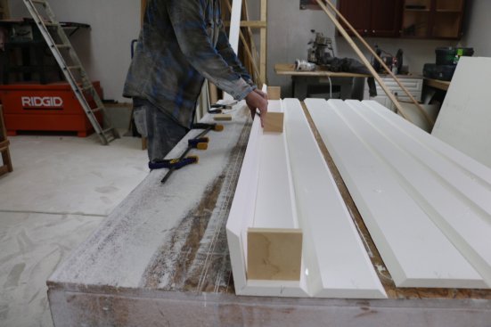

To glue the wraps together, I use Christy’s Red Hot adhesive in caulking tubes. I squeeze out a bead of adhesive in the second and third grooves of my three-side sections. Then I wait a couple of minutes. The adhesive actually heats up the PVC and makes the material in the groove more pliable.
When the glue is still wet, fold the three sides onto square wooden forms.
Nathaniel Eldon
Clamp the assembly at each square form and let the glue dry overnight.
Nathaniel Eldon

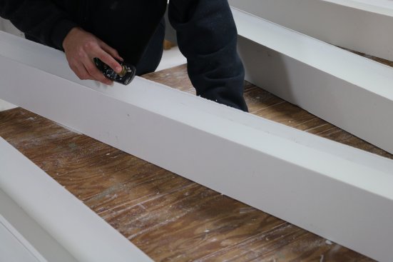

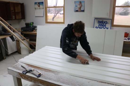

After letting the glue warm up, I fold one side up to make the first miter joint, starting in the middle of the wrap. The material sometimes makes cracking sounds, but it should stay together as long as I’ve made the groove the correct depth. After folding up the opposite side to make the second miter joint, I clamp the three-sided sections together using plywood blocks on the inside of the wrap to hold the assembly square.
A plane takes the rough corners off that were left by the router.
Nathaniel Eldon
On that cold and nasty February day, we fabricated the wraps for all six posts in my warm shop and let them cure overnight. The next day, we broke down the clamp assemblies and ran a sharp chisel along the inside of the miters to clean off any excess adhesive that had oozed out. Cline cleaned up the exposed miters with a block plane to remove the small bit of material that was left by the router when the grooves were cut.

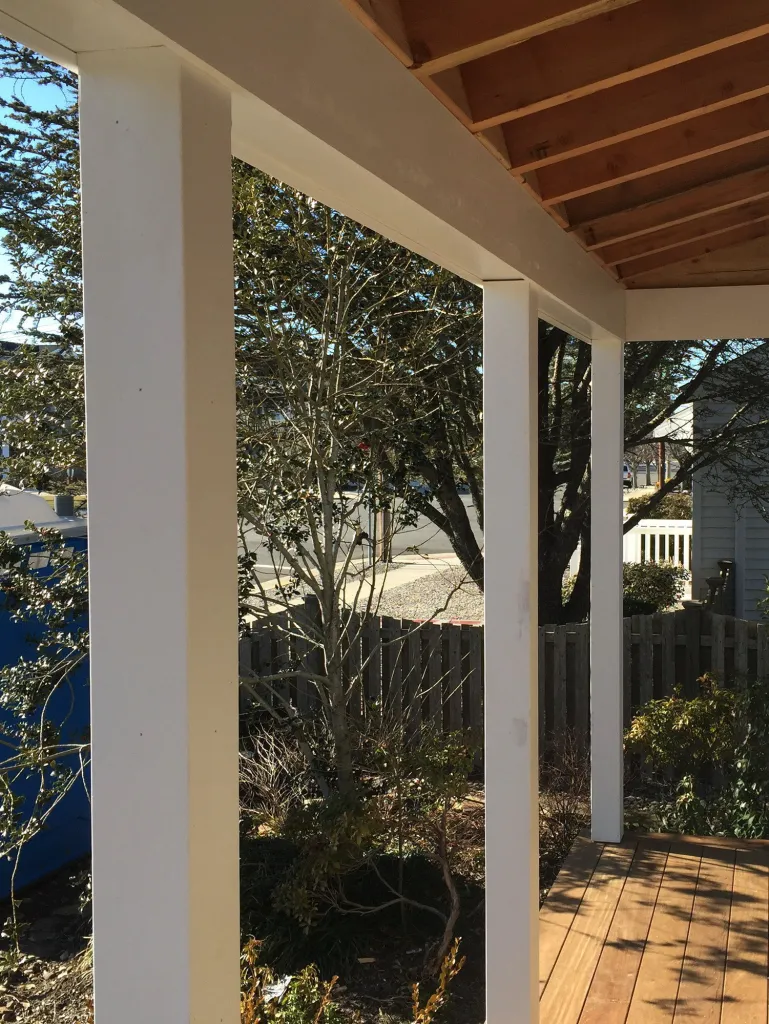

Once the weather decided to cooperate, we headed to the jobsite to install the wraps. I started by sliding the three-sided assemblies onto all the wood posts. I’d covered the beam that supported the porch roof in PVC, making the bottom part 5 1/2 inches wide, which let the post wraps fit in nicely below.

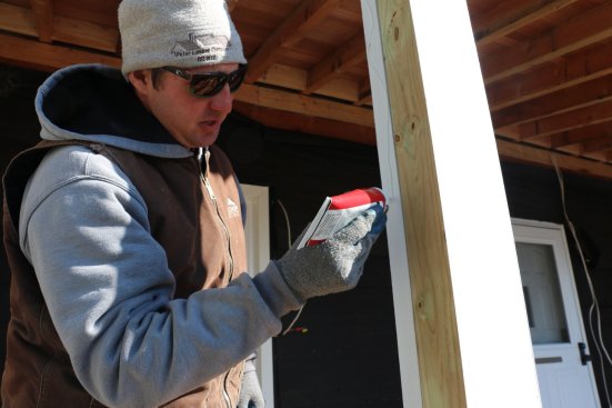

A generous bead of glue is applied to both sides of the post wrap.
Nathaniel Eldon

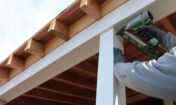

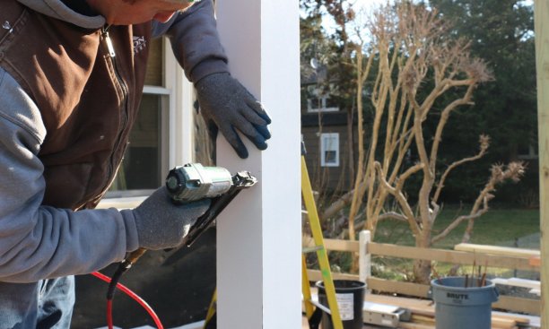

The fourth side of the post wrap is bedded in the glue and then held in place with 18-ga. stainless steel brads.
Nathaniel Eldon

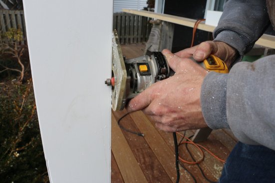

The final touch is routing the corners of the post wraps with a 1/8th-inch round over bit.
Nathaniel Eldon
I fastened the PVC assemblies to the posts with 15-gauge stainless-steel nails. After running beads of adhesive down the exposed miters, I fit in the last sides, fastening them with 18-gauge stainless-steel brads. To finish up, I eased all the corners with a 1/8-inch round-over bit in a mini-router.
