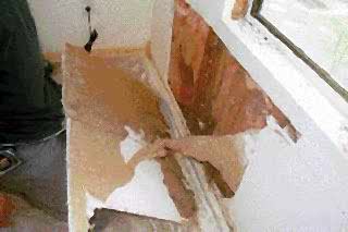

Every time it rained, water would soak the carpet under the windows of an acquaintance’s Southern California condominium. Built about 20 years ago, this former apartment complex had a standard three-coat stucco and lath finish applied over building paper stapled directly to framing; 2×6 rough-sawn wood trim was nailed through the stucco around the windows and horizontally around the entire building. Because the window, trim, and surrounding stucco appeared to be undamaged on the exterior, I suspected that water was probably following the trim’s nails right through the stucco and into the walls.
Hidden Bugs and Rot
When we went inside the house and opened up the gypsum wallboard underneath the window to expose the wood framing and the building paper, we found an enormous amount of damage. Not only were the framing members water-stained and starting to rot, they were also damaged and infested with termites. The king, trimmer, and cripple studs underneath both window jambs were almost completely destroyed, robbing each member of virtually all load-bearing capacity. And water damage had completely worn away the building paper in several places, exposing the back of the stucco.

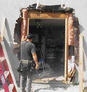

Our architectural firm, Lohse2, specializes in investigating water leaks and other building failures. To locate sources of leaks in building envelopes, we often perform water tests on window and wall assemblies with a spray rack built to ASTM E1105 specs. In this project, as soon as we turned on our spray rack, water poured in around the window in several locations. Spray tests are normally conducted for 15 minutes, but we had to turn off the water after only a couple of minutes because so much water was pouring through the window and wall assembly.
When we removed the exterior trim from around the window, we found holes as big as 1/4 inch in diameter blown through the stucco where the nails attaching the wood trim had once been driven. We then removed the stucco 12 inches around the window, all the way down to the stucco screed. Our original hypothesis was correct: Everywhere there had been a trim nail driven through the stucco, there was corresponding water damage to the flashings, building paper, and wood framing.
The termites seem to have favored the wood that had been affected by water intrusion. We found the greatest termite damage on wood that was already stained and that got wet during our spray test. With the stucco removed, that damage was even more evident.
Considering the damage to the framing around the window, it was a wonder the wall was still standing. The king, trimmer, and cripple studs had not only been completely eaten away — they were not even bearing on the mudsill. Fortunately, damage to the wood framing in this part of the building was limited to the window area, but we suspected that other walls in the complex — which have both the same window trim detail and an additional horizontal trim detail — had similar damage.
